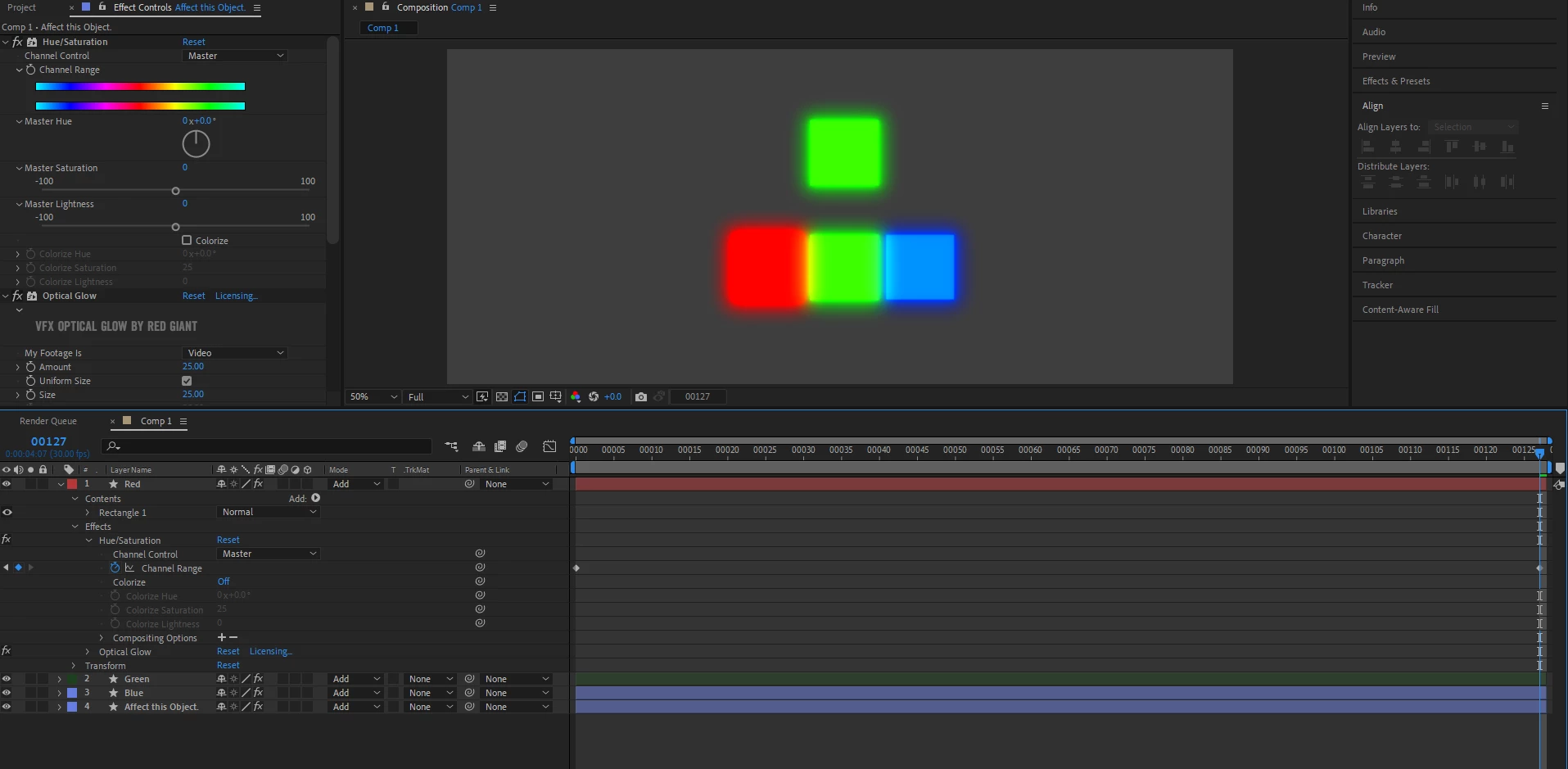

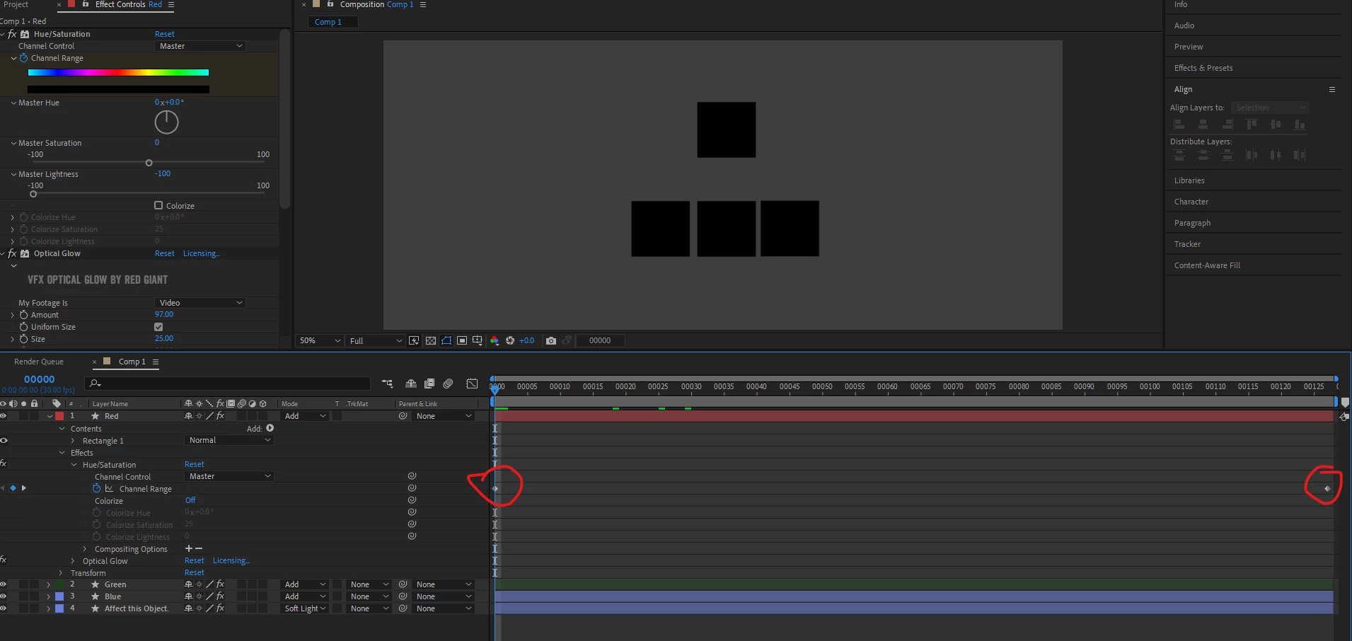

Hi community.
Is there a way seperate objects of  R G B can be individual entities and affect one particular object like a colour picker.
https://tuneform.com/tools/color/rgb-color-creator
I have 3 rectangles RED GREEN BLUE, each has the Hue effect, and goes from 0 to 100.
Red goes from black to Red 100%, Same for the Green and same for the Red.
This is what I'd like to ahieve if possible in AE, (and then also add some effects to it)

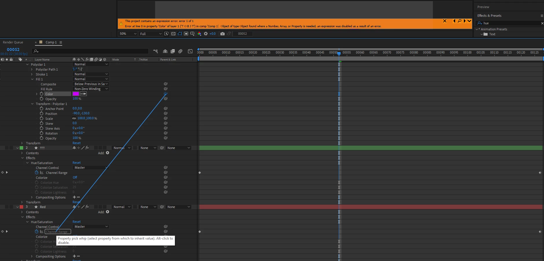

Hi Mylenium.
This seems like a hard one to do, any tutorials online for such a task?  I was about to post this as well in case its easier, because I'm confused with the reply you wrote.
I'm trying to pick whip the purple layer to the HUE values of the Red and Green Layers, so it can inherit its HUE values, so I can slide each colour independently.
