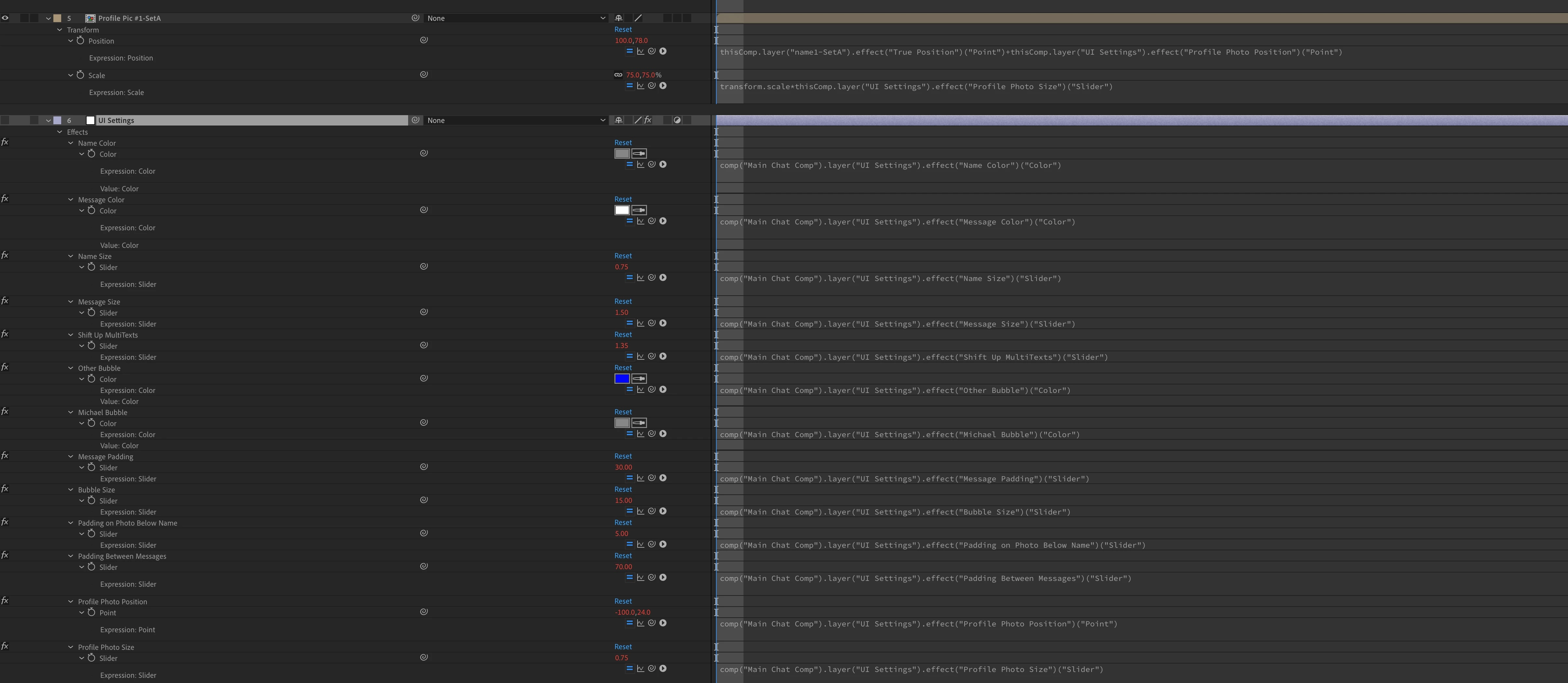

I'm having issues with a stack overrun expression error. It's a unique issue because the error disappears when I search for the error by clicking on the magnifying glass. I am able to render the the comp without any issues but the problem is that when I'm using third party automater "Templater" to render the composition remotely the expression error is haulting the render.
Any tips on how to remove the stack overrun expression error? I'd like to avoid removing or simplifying the expressions since I know After Effects is able to handle them when I render manually.

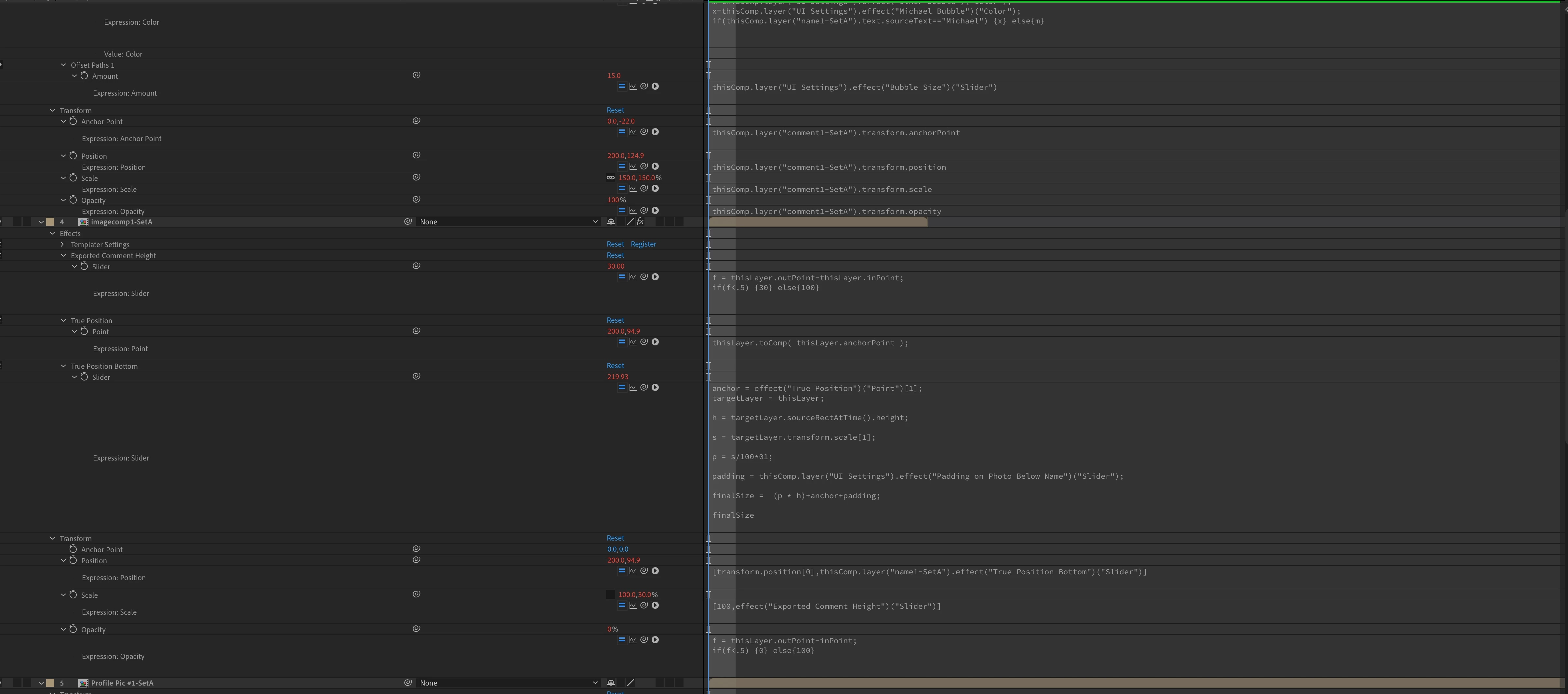

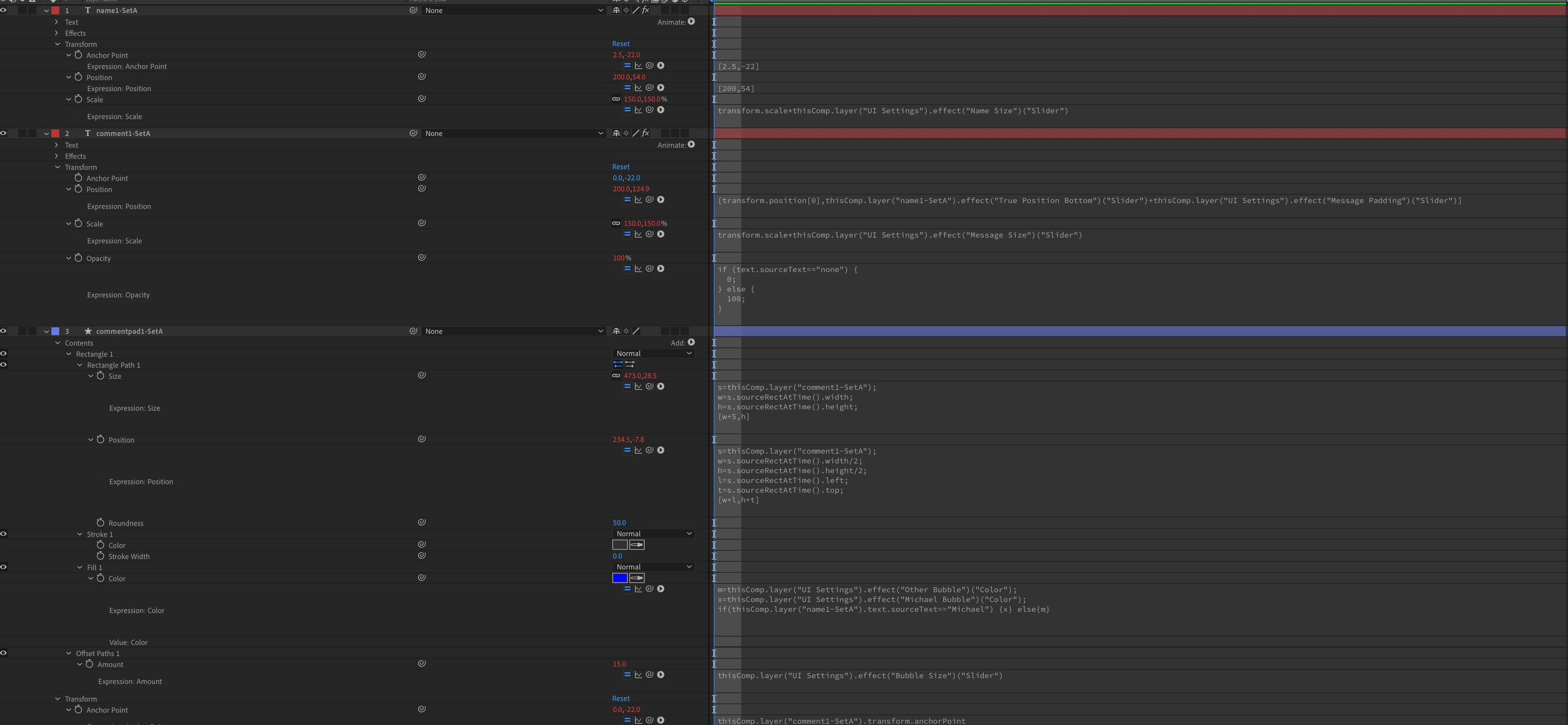

thanks for getting back to me! here's a breakdown of the issue. I've also attached a few screenshots of the referenced expressions. Any help would be hugely appreciated as I've been at this template for over a month now.
