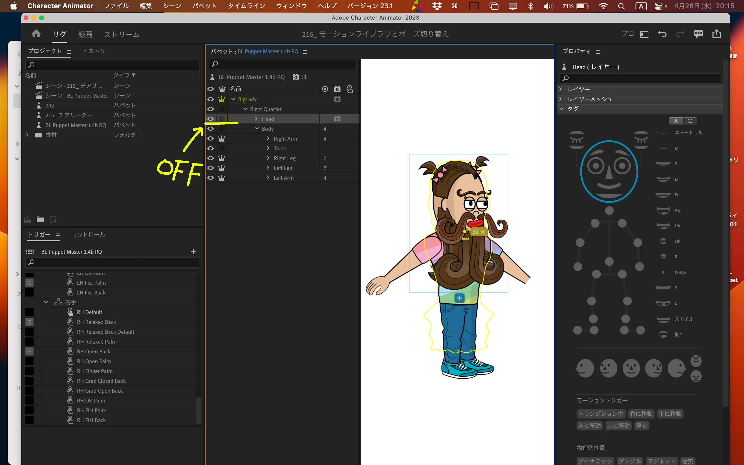

Your puppet had a crown mark on the head layer.
By removing the crown mark, the head and body are connected.
Also, there was a head tag on the RightQuarter layer. I removed it.
Here is a modified puppet
https://drive.google.com/file/d/1bgtQIBVPBfx-_kP-VmRnDCre4HnPRJLm/view?usp=sharing

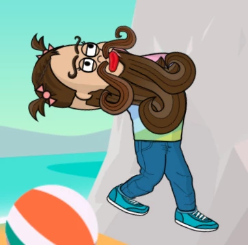

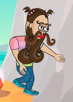

I just tried some different motions and it still has some problems, do you know how I can fix this?
Parkour 1
Parkour 2
Thanks

You have a lot going on with your puppet, so it's not surprising to see that it doesn't mesh with some of the more extreme motions. I couldn't get ginga dance to work well, but the jazz dances worked fine. I don't have a great deal of experience with the motion library, so I'm not sure what to suggest.
