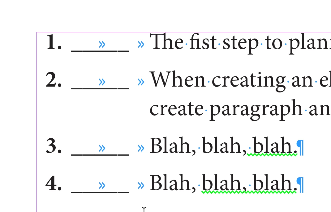

It appears that bullets and numbers have been implemented by hijacking tabs and indents. As far as I can tell, this makes it impossible to do a hanging indent as you see fit.
So now, to get lines of text after the first one to show up with a hanging indent, I have to put a hard return at the end of the first line and create a whole other style for subsequent lines. Lame, to say the least. Am I overlooking some other option? And no... tables are not an option for us.

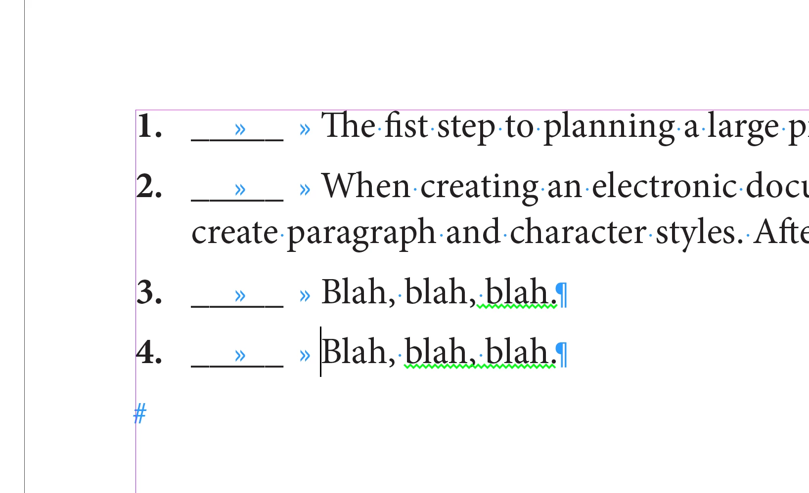

In this screen grab, the examples at the top show what the text needs to look like. The underline is created by a tab with a leading _ character. The apparent hanging indent is accomplished with the hard returns.  The one I'm working on shows why:

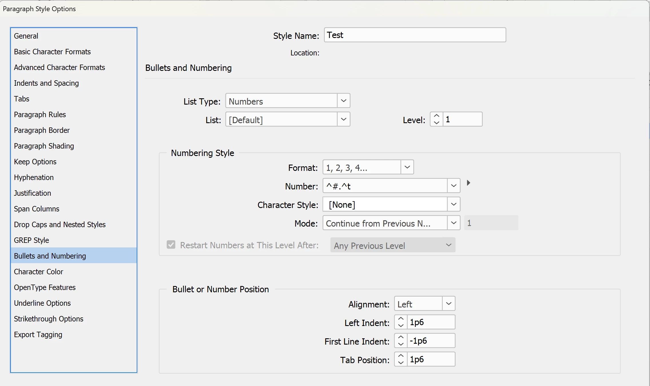

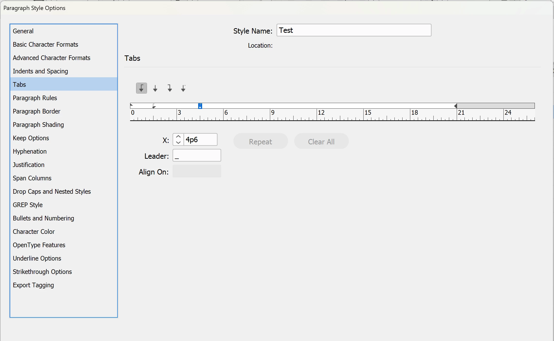

Mike Witherell
October 9, 2025

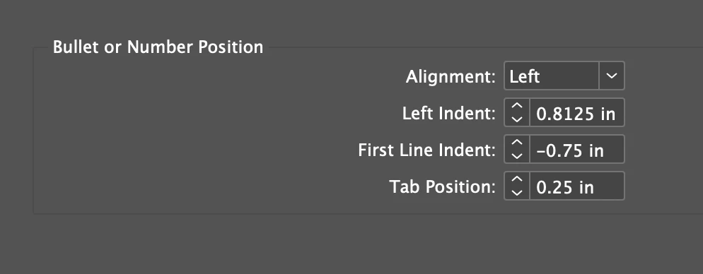

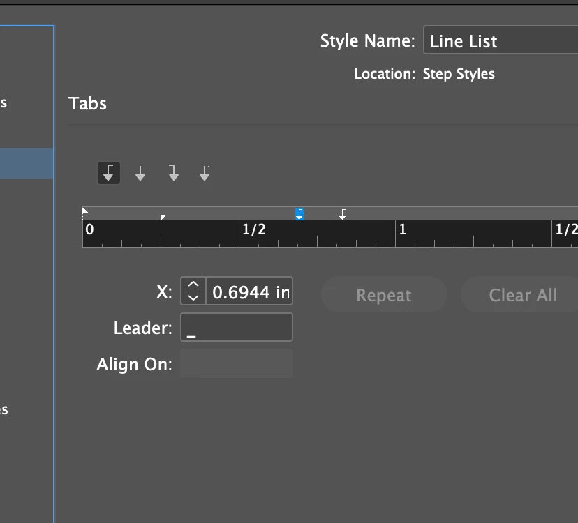

So what you want is the Numbered list to define the first tab position in a paragraph style. In my example, notice how the left, first, and tab position are defined:
Then, in Tabs section of the paragraph style, notice the second defined tab that makes the underscore:
This second tab has underscore characters defined in it. There are no other tabs defined in the paragraph style.
It is true that the Tabs panel is small and too fussy to aim your mouse at. Ever since PageMaker 1.2 it has been too small and fussy. And yes, the left indent (which you can shift-drag, btw) must equal the tab position, it cannot be ahead of the tab, or else it nullifies the tab. This is not a bug. To delete an existing tab, drag it downwards. I avoid using the Tabs panel by defining a paragraph style, and defining distances in the paragraph style options dialog box.

Thomas_Calvin作成者
October 9, 2025

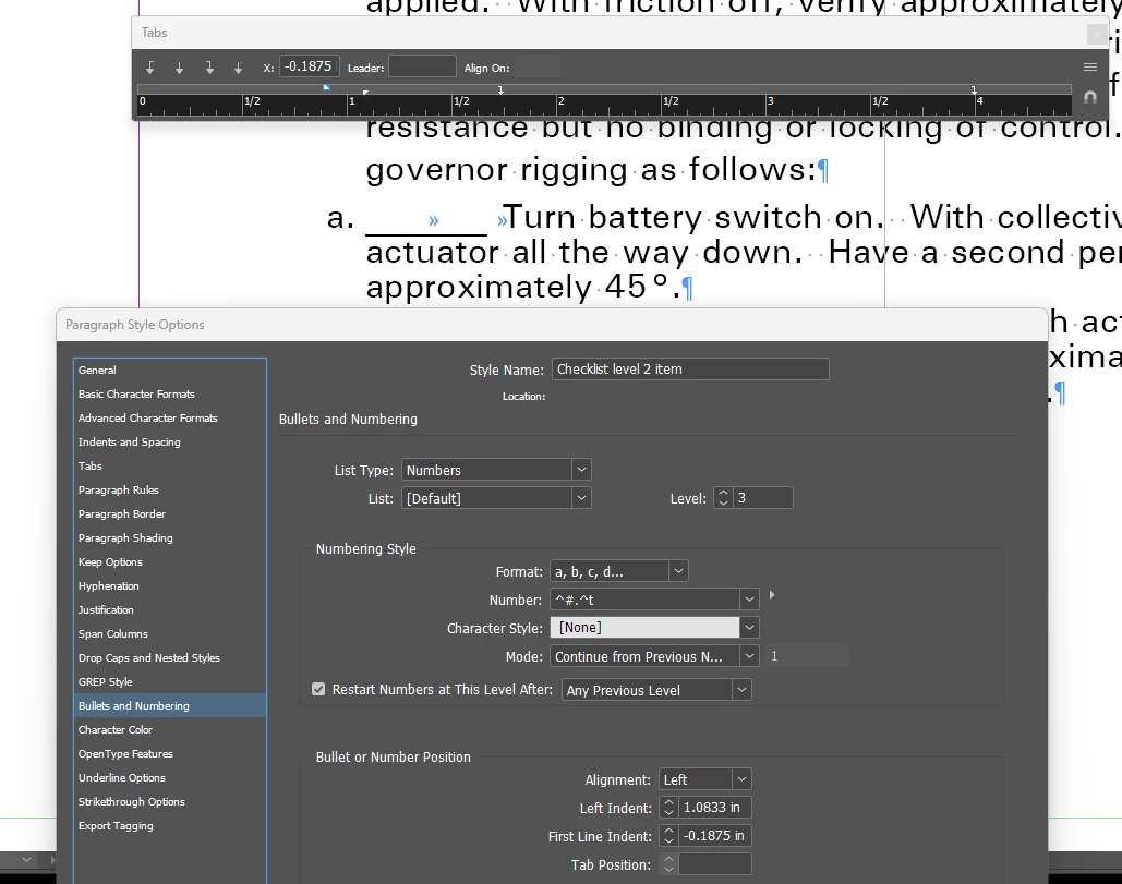

Yes, it turns out that there's a bug where the first tab (or its leader) will not work if the hanging indent is set to the right of the first tab stop (or possibly equal to it; not sure):

To get the initial hanging indent, simply "push" the left indent in, then "pull" the first line out (with a negative number). InDesign automatically sets the tab. (Tabs are almost always the same as the left indent.)
The line tab and the spacer tab need to be set under tabs, with the line tab using a underscore as a leader character. These two tabs need to be entered manually.

So far no one has been able to work around the problem, which is the hanging indent messing up the tabs on the first line. Look at your #2; it's not correct. "Create" is not lined up with "when." The hanging indent needs to be to the right of the underline.

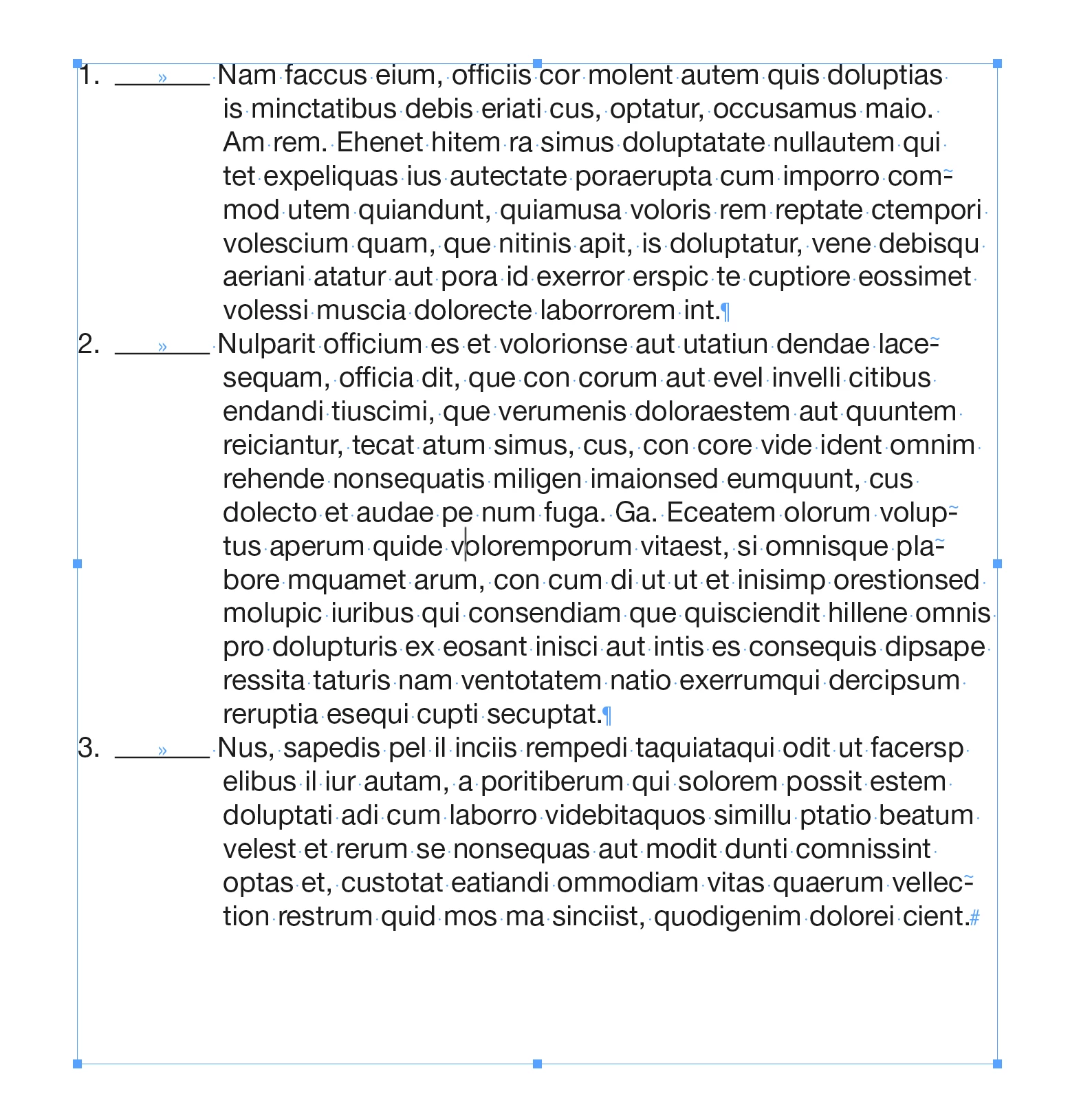

Dave Creamer of IDEAS
October 8, 2025
When I watched the youtube in small view, the top was cut off.
Simple fix:

You do have tab disagreement. Get rid of all the other tabs that are defined and content yourself with defining just the one that coincides with the hanging indent distance.

You can set tiabs in the tabs section of the paragraph style or in the bullets n numbering section of the paragraph style. They should agree. IOW, do one or the other (or both as long as they agree). Don't allow the definition to disagree.

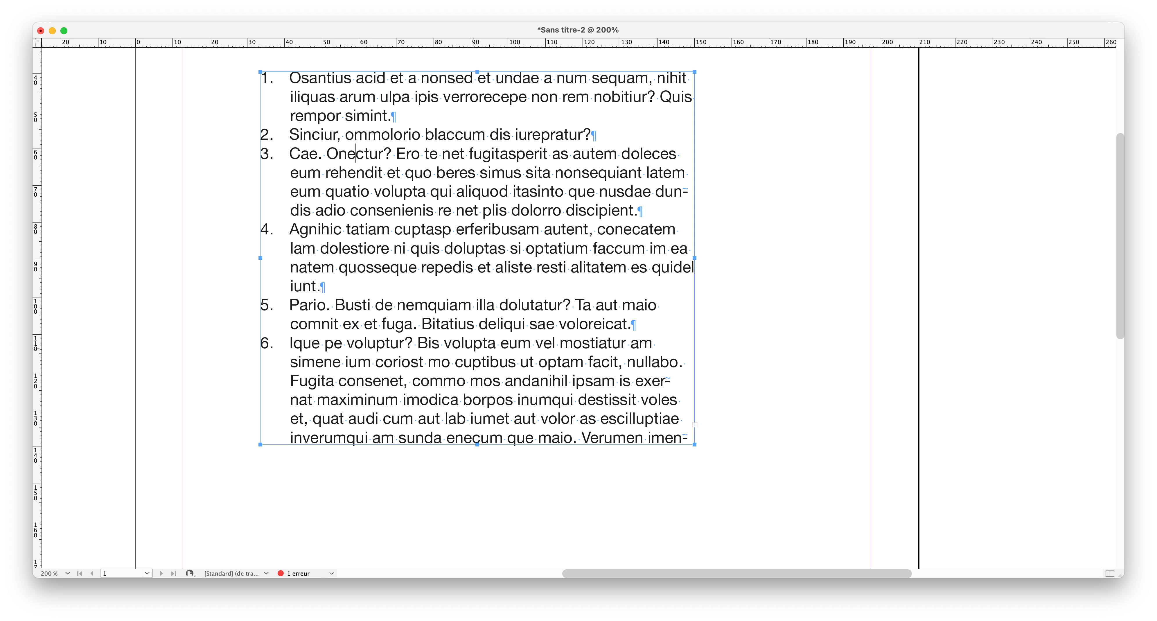

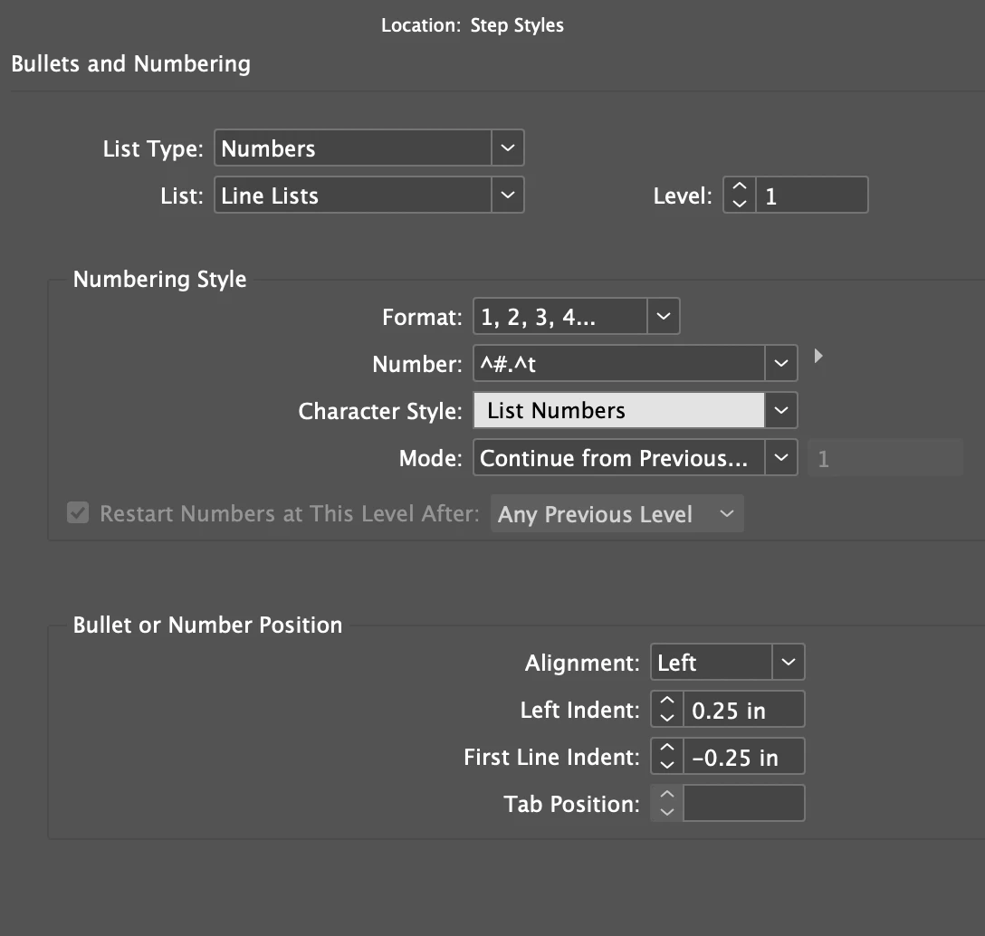

jmlevy
October 8, 2025
See screen grab below

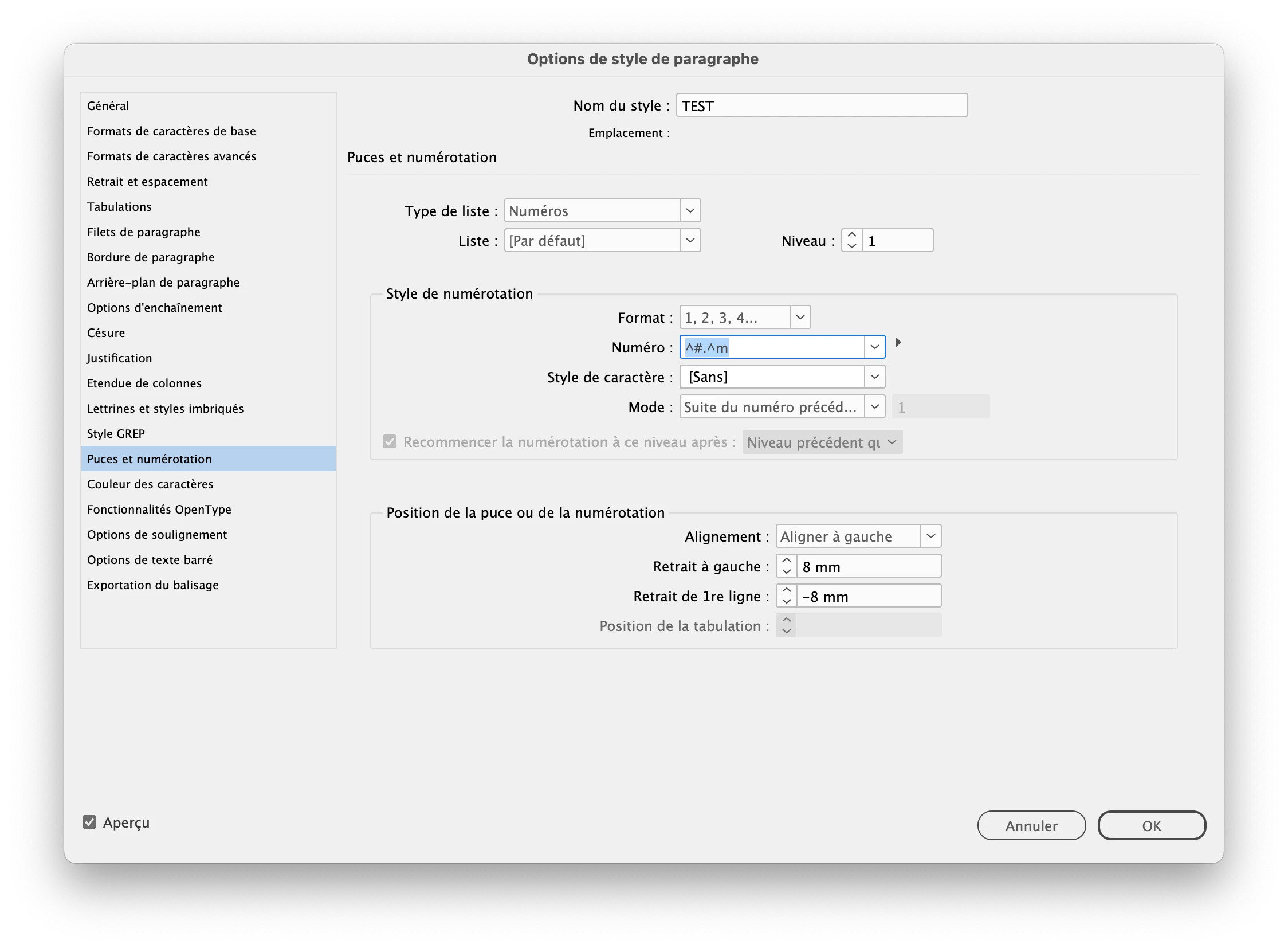

jmlevy

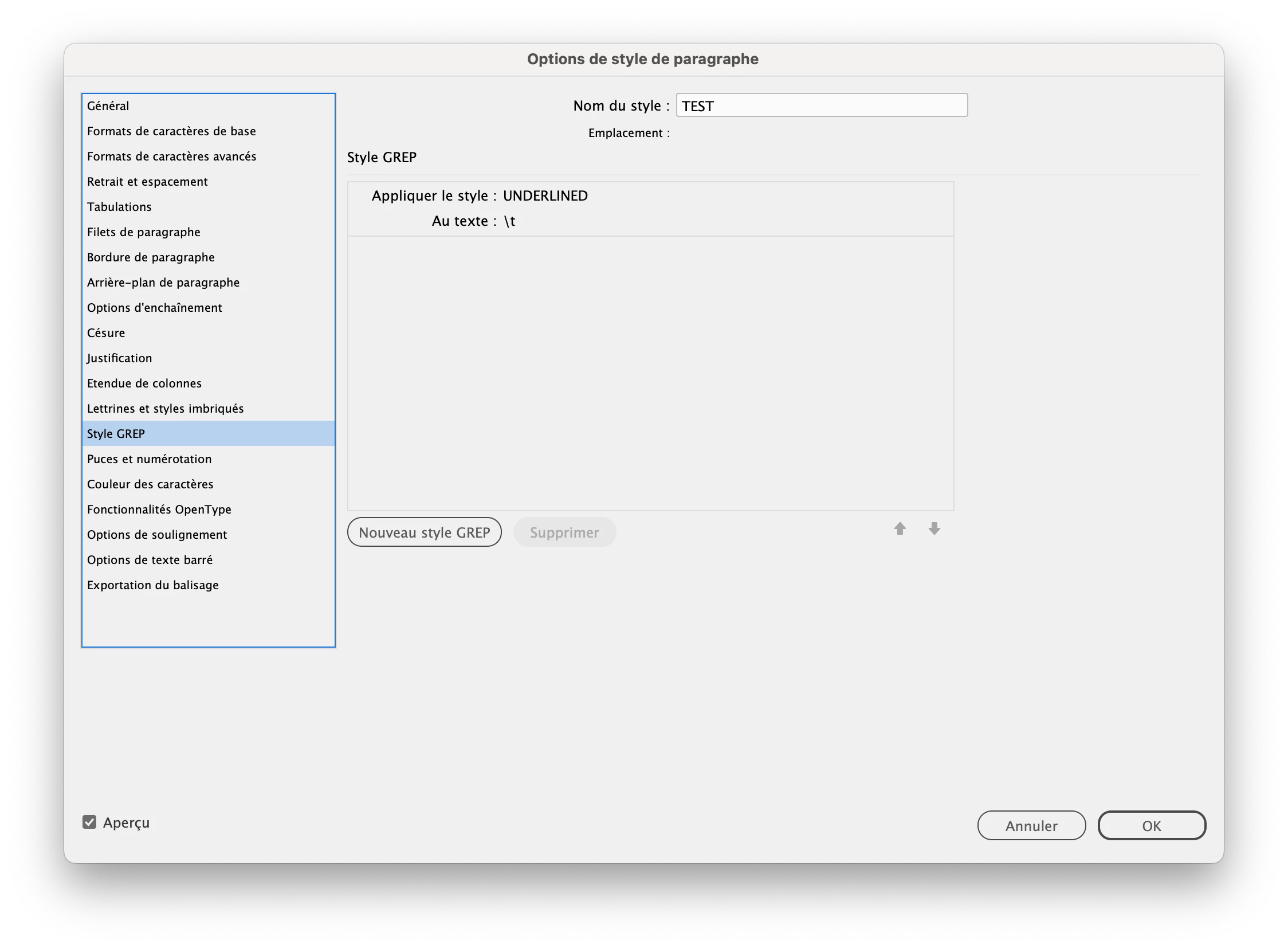

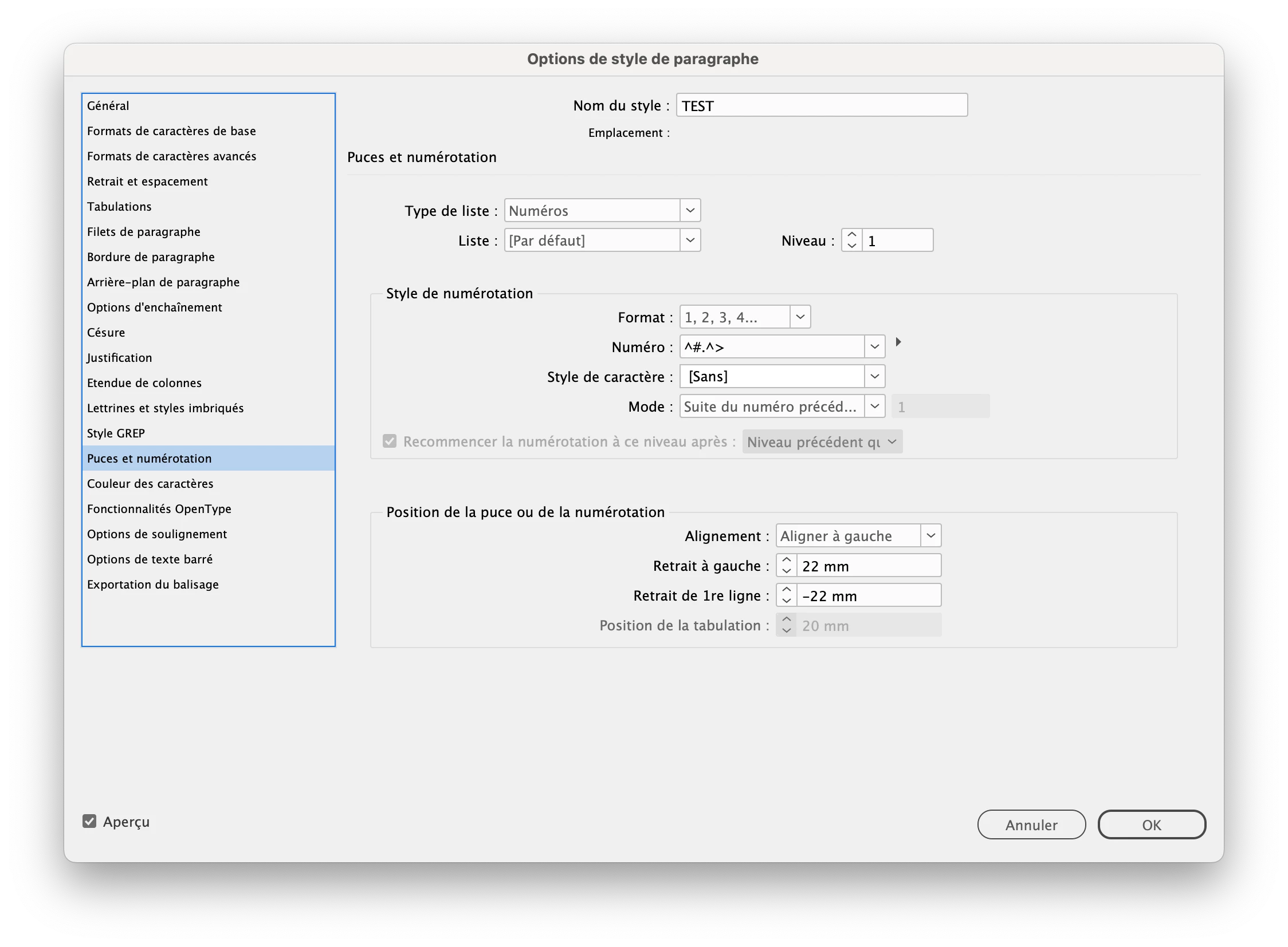

October 9, 2025
Hi @Thomas_Calvin Maybe I don't understand what you need but I can't see what prevent you to set a paragraph style as below:
