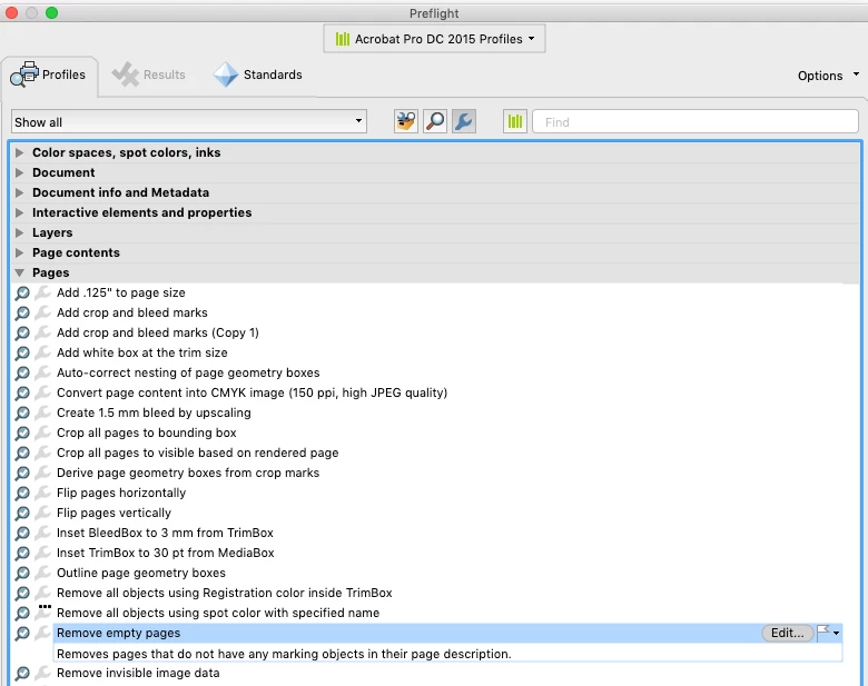

    This isn't exactly what you need, but you might find it helpful.
    Create a new InDesign layer, name it something like Not Printing, and set the layer properties to Print Layer (off).
    When you don't want a page to print, move all the contents to this layer, this will create a blank page on your exported PDF.
    You can remove the blank PDF pages in Acrobat using the Action wizard to run a preflight profile that will remove the blank pages and rename the file with one click- Fixups> Pages> Remove empty pages.
    If you decide you want the page to print, move the contents back to the original InDesign layer and export to a new PDF.
    Note, you won't be able to see the page contents in InDesign that reside on the Not Printing layer, with Overprint preview turned on.

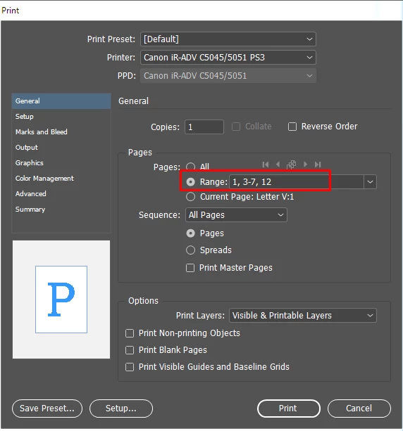

    joet082964
    April 30, 2019
    You can easily specify which pages you do want to print, leaving out those you don't want.
    In this example, I want page 1, 3-7, and 12. Is this helpful?
