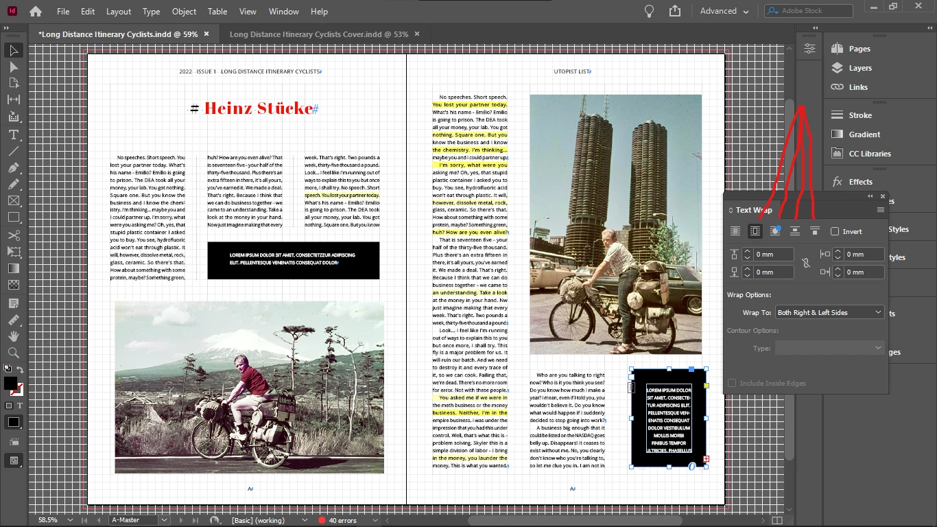

As visible on the screenshot, my image has a bottom offset, but the black box doesn't have any offset.
However I still expected the black box to displace the text column under it, if I place it on the top, especially because it has the same dimensions as the text column, but it doesn't.
Am I supposed to just delete that text every time, or is there a setting that would enable the box to displace or delete the column under it automatically, if they have the same dimensions (so it's obvious to the app that the text won't be visible under it anyway).
And, is there any way to snap offsets to document grid (like the bottom offset of my image), especially if "Snap To Document Grid" is enabled  in the Grids & Guides menu?
I can't grab the offset to adjust it, then it would perhaps snap. I only can adjust the distance in the text wrap settings. How do i grab the offset to drag it to see if it snaps to the baseline grid?
Thanks in advance.

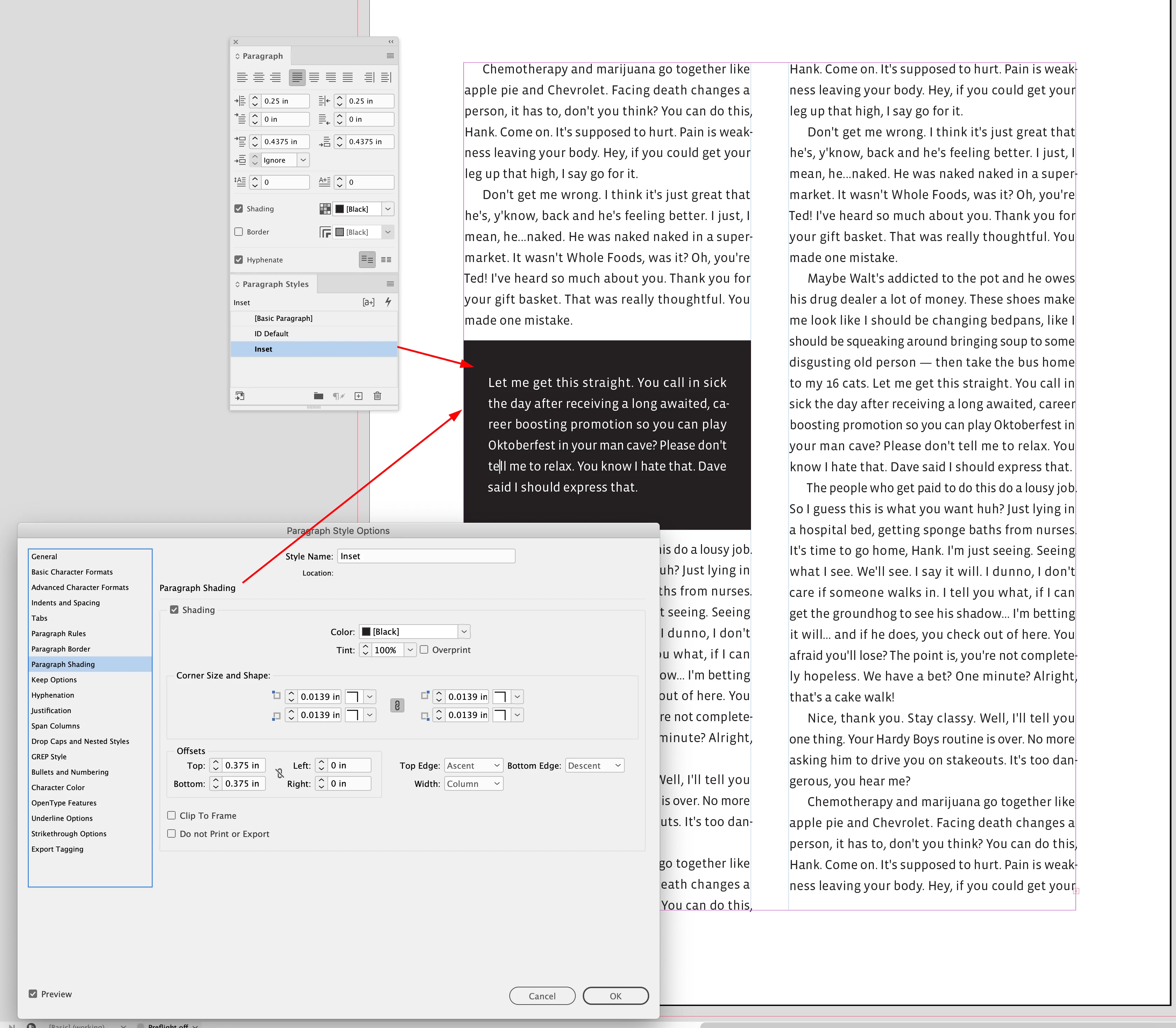

Look at Paragraph Shading. You should be able to do this without creating an extra text frame:
Chris  P.  Bacon
August 18, 2022
Just what I needed, thanks.

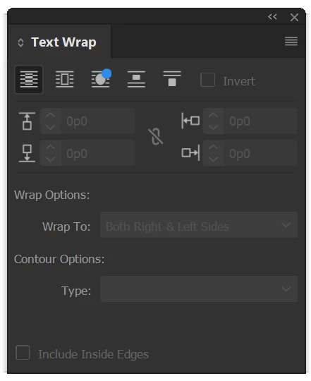

I believe you are looking for Text Wrap. The wrap settings need to be applied to your black box.

Derek Cross
August 17, 2022
Have you tried Window > Text Wrap ?

James Gifford—NitroPress
August 17, 2022
Set the text wrap characteristics. You want either wrap around bounding box, or wrap top/bottom, aka "jump object."
With most, you can also set the wrap margin from other elements.
By default, most objects are set to "do not wrap," which is what you're seeing in your screen shot.
Chris  P.  Bacon
August 17, 2022
Each of the 4 options removed the text under, I have chosen the second: "Wrap Around Boundig Box" and it seems to remove the text under even if the wrap dimensions are set to zero. That's nice cause I really didn't want to see an extra offset box there because there is no actual need for an obset, I just wanted to not allow any text under the black box. Great, sorted out, thanks.
