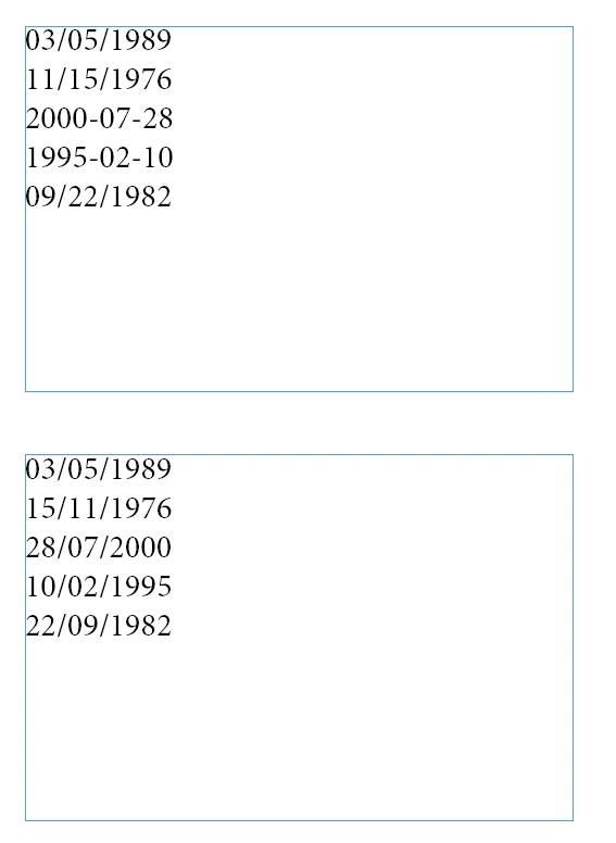

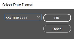

A script could work like this - you select the date formats you want to change
whatever your date format might be
dd/mm/yyyy
yyyy-mm-dd
etc.
Then run the script - it inserts the age
And beside nonconforming date formats it will insert NaN - you probably don't want this
But the drop down lets you decide what your date format is which can be adjusted in the script
It's optional - you can just tell us the date format and we'll put it in that way - or you can adjust yourself
I notice it's not working entirely correctly - but can be fixed
Run the script
It will work on every text frame (should do)

// Show dialog to select date format
var selectedDateFormat = createDateFormatDialog();
if (selectedDateFormat !== null) {
    processAllTextFrames(document, birthDates, selectedDateFormat);
Just an example.
