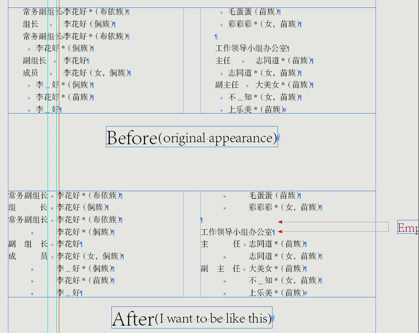

Is there any specific algorithm relationship between Letter spacing and font size in InDesign?
  • June 13, 2023
  • 返信数 4.
  • 5363 ビュー
ABCD Name
AD Name
ABD Name
I need to align the three above.
Some people may use grids, but that feature is difficult to use and I usually don't use it. It's better to use font spacing.
However, it is troublesome to adjust the font spacing. For example, when the font size becomes larger, I have to try every Letter spacing value.
Just want to ask: What is the relationship between font size and spacing, can we calculate it?

m1b
June 15, 2023
Hi @dublove5CFE, the issue here is converting tracking units (which I assume you are using to space out the A in the second line) into ruler units. Tracking is measured in em units which relate to the font size. The conversion factor is, 1000 / font size. Some fonts have differing sized em squares but Indesign seems to calibrate them all to 1000 units in terms of the UI and scripting API. You can see how it works in this script, that attempts to solve your problem.

In the script you can see the conversion into em units here: <ruler distance> * (emSquare / chars[j].pointSize). Where emSquare is 1000.
Note that for convenience I altered your example so that every paragraph has a tab character to tell the script where to align. The script will only work if there is a tab in every selected paragraph—it will try to align the text before the tab. Here is what it does when I run it:
Let me know if that helps.

Hi @dublove, I've re-written script to fit your demo document. Give it a try and let me know how it goes.
- Mark

Robert at ID-Tasker
June 14, 2023
What EXACTLY are you trying to achieve?
June 13, 2023
A,B,C,D,N,a,m,e - each one has a DIFFERENT width chosen by the font designer. But they scale reasonably exactly with the font size - if you go from 12 point to 24 point the letter spacing (for each letter, for that specific font and weight and style) is exactly double.

Peter Spier
June 14, 2023
You can type (or place) your tabbed text normally, then select it and Table > Convert text to table...
Peter Spier
June 13, 2023
Letter spacing (kerning values) are set by the type designer and generally vary withthe combination of glyphs. For consistent spacing no matter waht the text might be you would need to use a mono-spaced font like Courier, or create your own.
I suspect this might work better if set up as a table. You could then use full justification in your paragraph styles to completely fill the width of each cell regardless of the number of characters.
dublove5CFE作成者
June 14, 2023
The table is too cumbersome. Not a good idea

@dublove
Here is initial comment from the latest code created by m1b:
 * Notes and assumptions:
 * - Script assumes each paragraph is a single line.
This condition = "convert to table and forget" - earlier idea from @Peter Spier to use table... And would also automatically work for multiline paragraphs.
