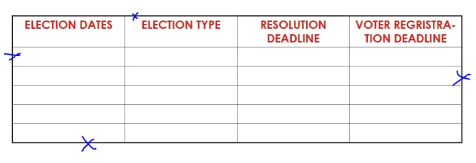

I have tried so many options but can't get these borders to go away or at least change color. Can someone help?

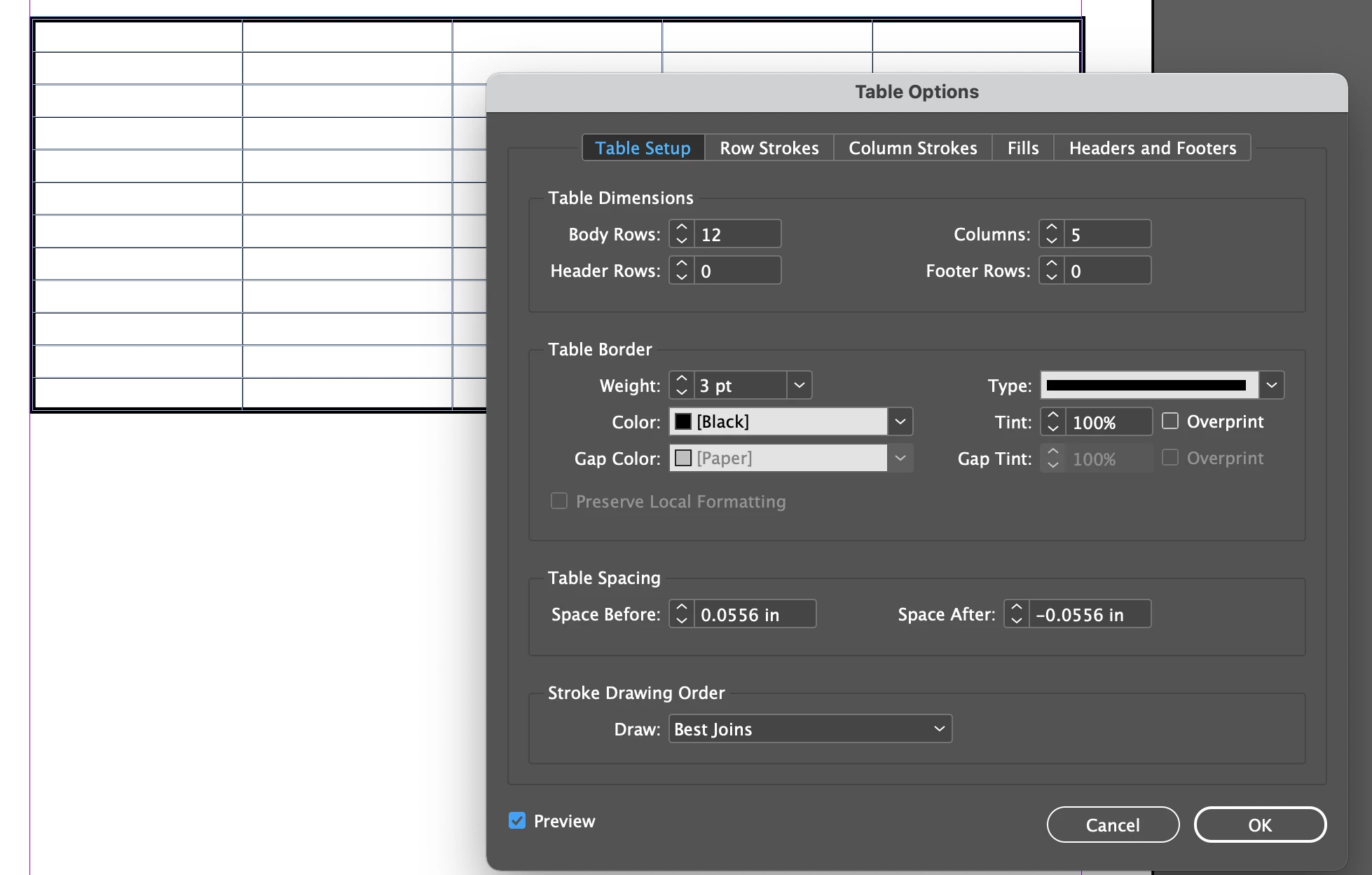

Thank you for reaching out. The suggestion shared by @SJRiegel is correct. First, you may select the Type tool, take the type cursor; it should be blinking inside the table; otherwise, you won't get Table setup clickable in the menu, and then go to the Table menu > Table Options > Table Setup > Table border > Weight = 0. I hope it helps!

Under Table Setup, look at Table Border
