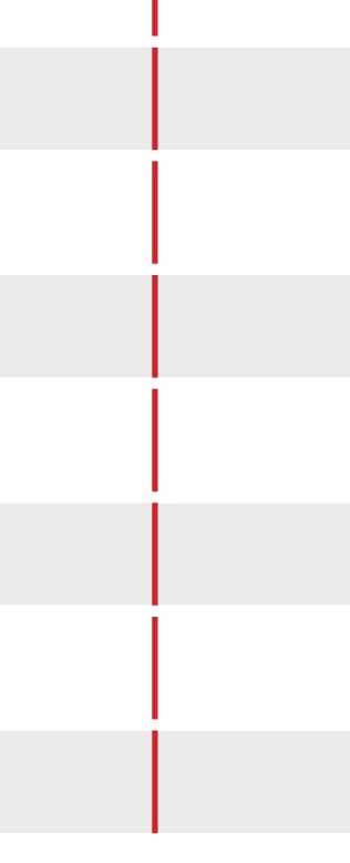

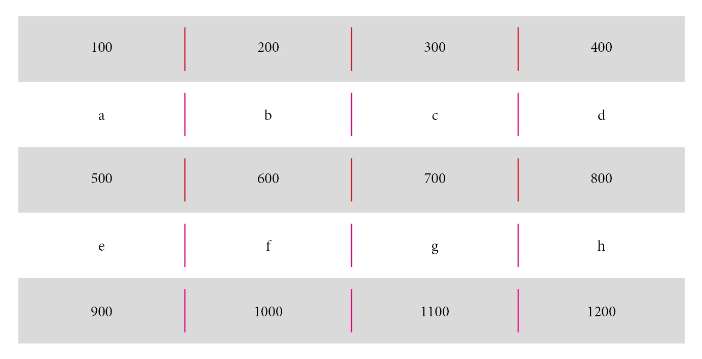

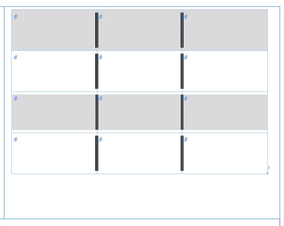

Hi Good Day,
One of our colleague created a design for table and we will converting it to indesign table. Is this posible to indesign. I'm trying gaps but it will take only one color.
The below is what i'm gettig, the grey side doesn't have the gaps on top and bottom since the gap is white.
Hope someone can help me...

September 14, 2020
Hi learizam,
looked again at your screenshot in your first post.
Don't know, but are there two gray fills at play? Alternating fills for every second row?
Then you could fill your rows "traditionally", not using diagonal lines.
But you have to use the stroke type "None" as shown in my last post above:
Uwe Laubender
( ACP )
September 14, 2020

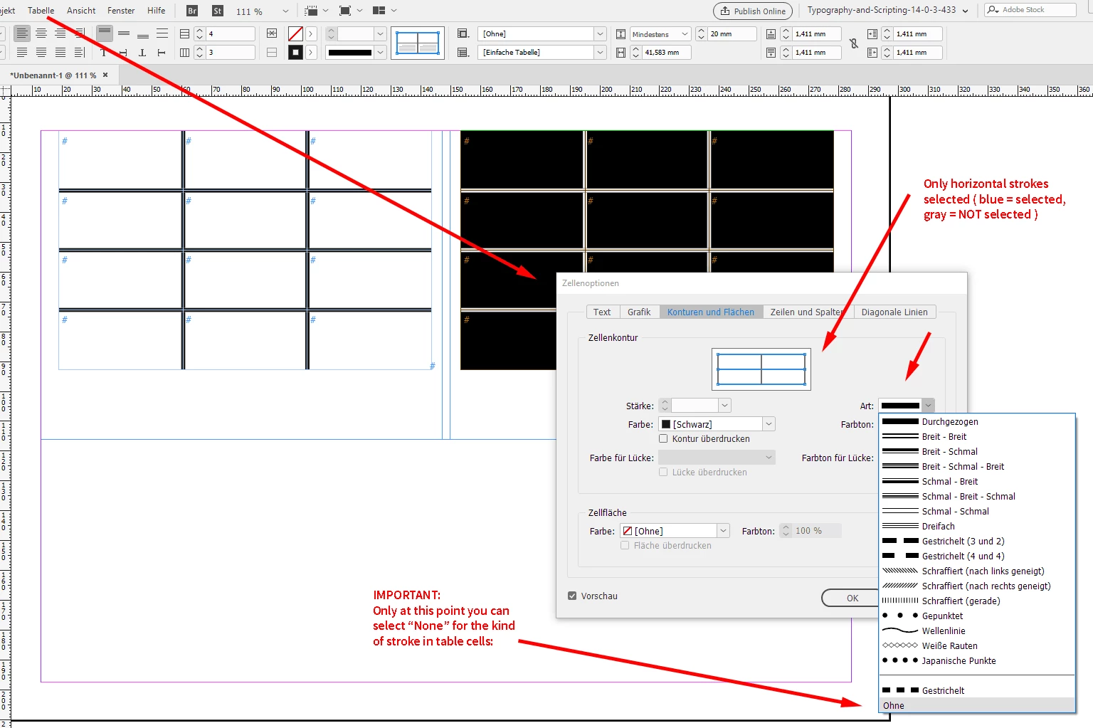

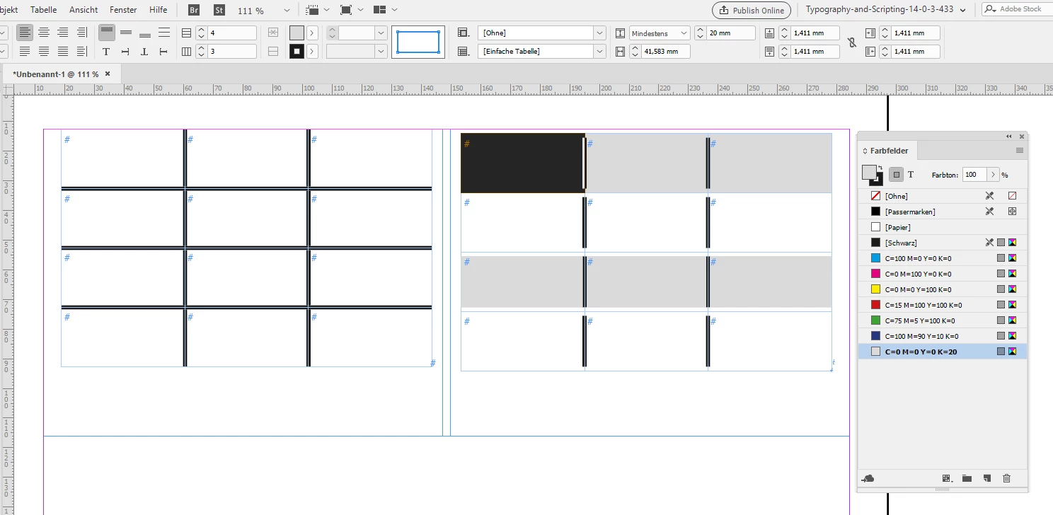

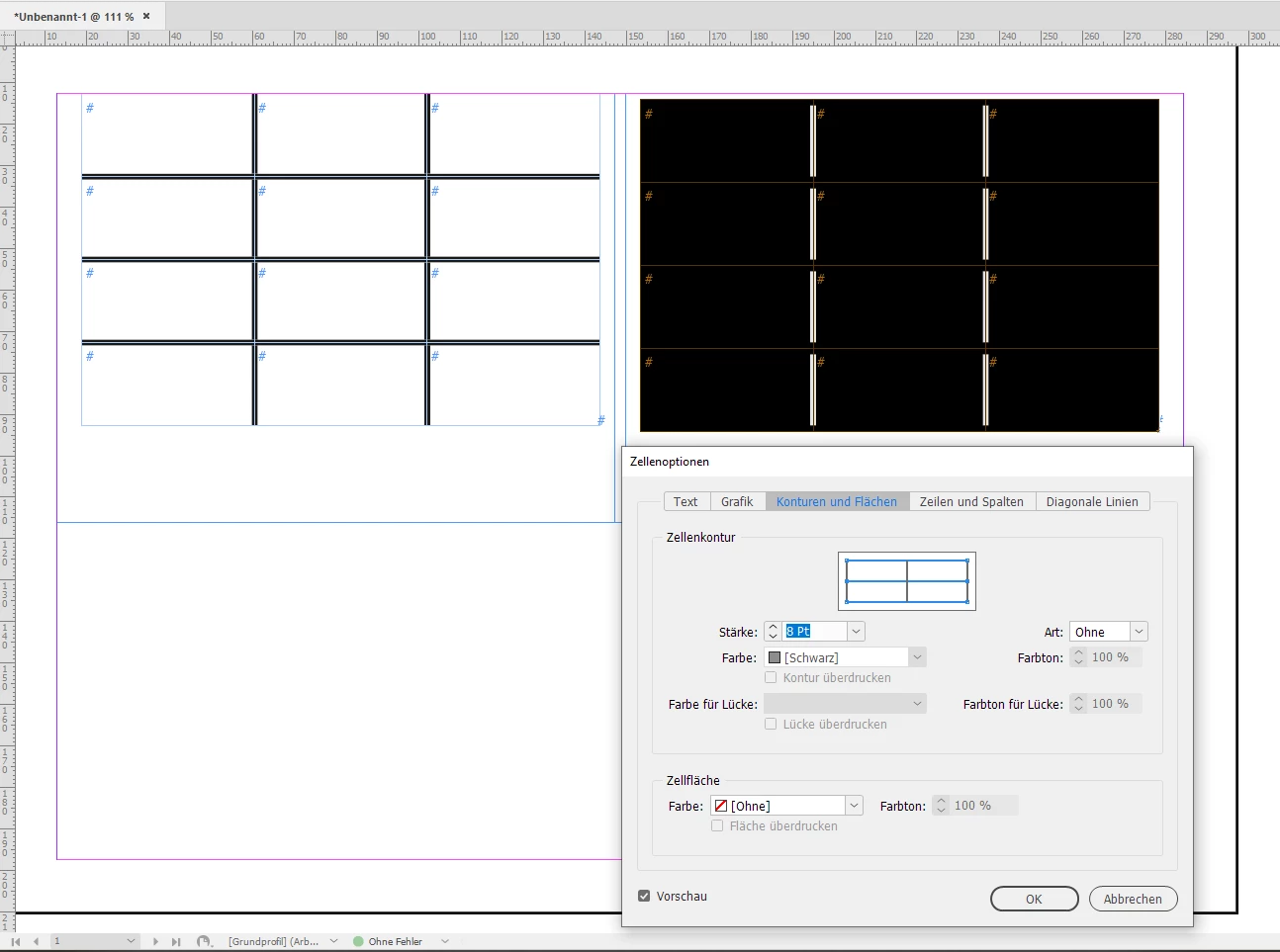

Hi learizam,
what you try to do is possible with a seldom used feature in table cells.
It creates a stroke with an actual stroke width but with the stroke color [None].
Example below.
All the horizontal strokes have a stroke weight, but no visible fill color.
The first row is filled "traditionally", the third row is filled "special":
How could we do this?

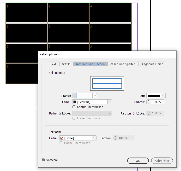

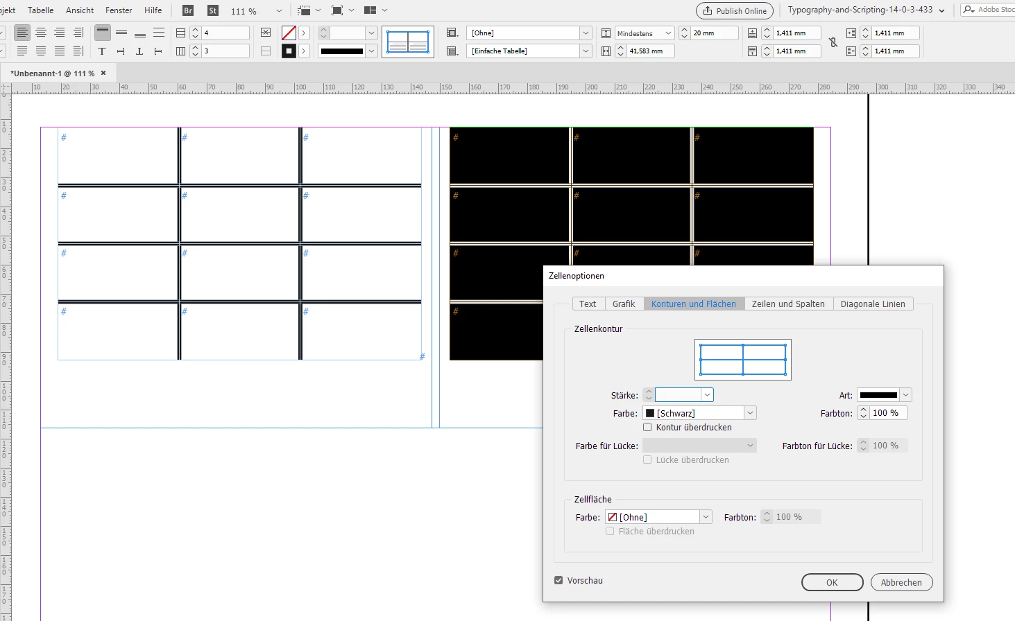

First do the stroke weight with no color. Go to:
Table > Cell Options > Strokes and Fills
From my German InDesign:
[1] Select all cells in the table ( select one cell and then do Select All )
[2] Open dialog Cell Options > Strokes and Fills through the Table main menu
[3] In the widget for cell strokes, select horizontal strokes only. Click on the vertical strokes to make them gray, that is the indication for not selected:
[4] Now comes the most important part. For Type scroll down to the bottom of the list and choose "None". Make sure that Preview is on. You already will see the horizontal gaps between the rows if your stroke weight is large:

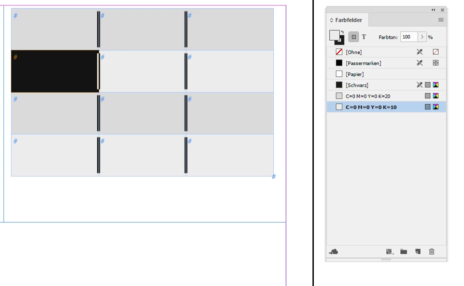

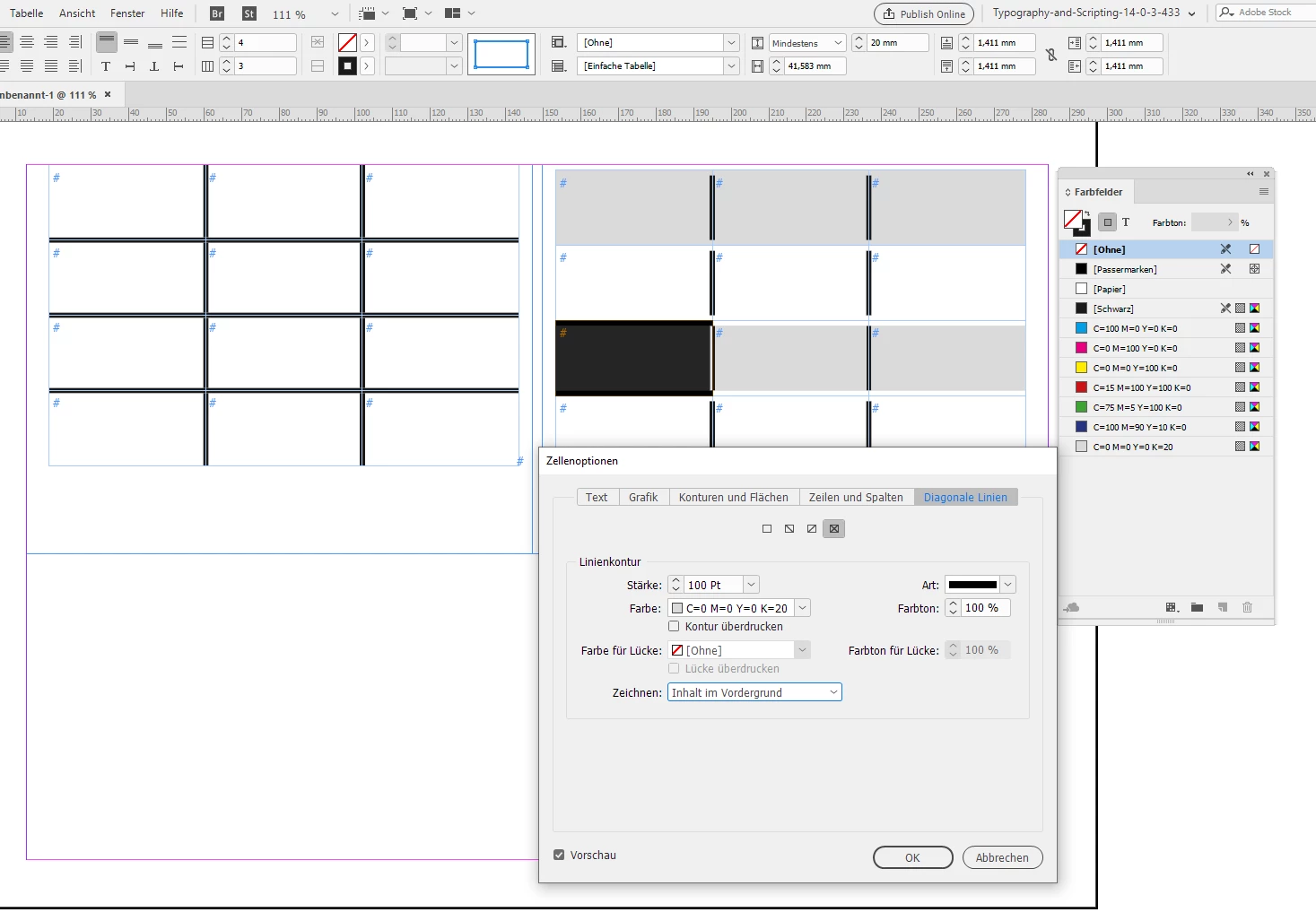

[5] Now for the fill of all all cells in a row. The "traditional" method will not work: Select all cells in a row and apply a fill color from the Swatches panel:
Instead, and here comes trick #2, use a diagonal stroke as a fill with a huge amount of line weight. In my case below I did a 100 Pt stroke diagonal line. You'll find this feature in the last tab of the Cell Options dialog:

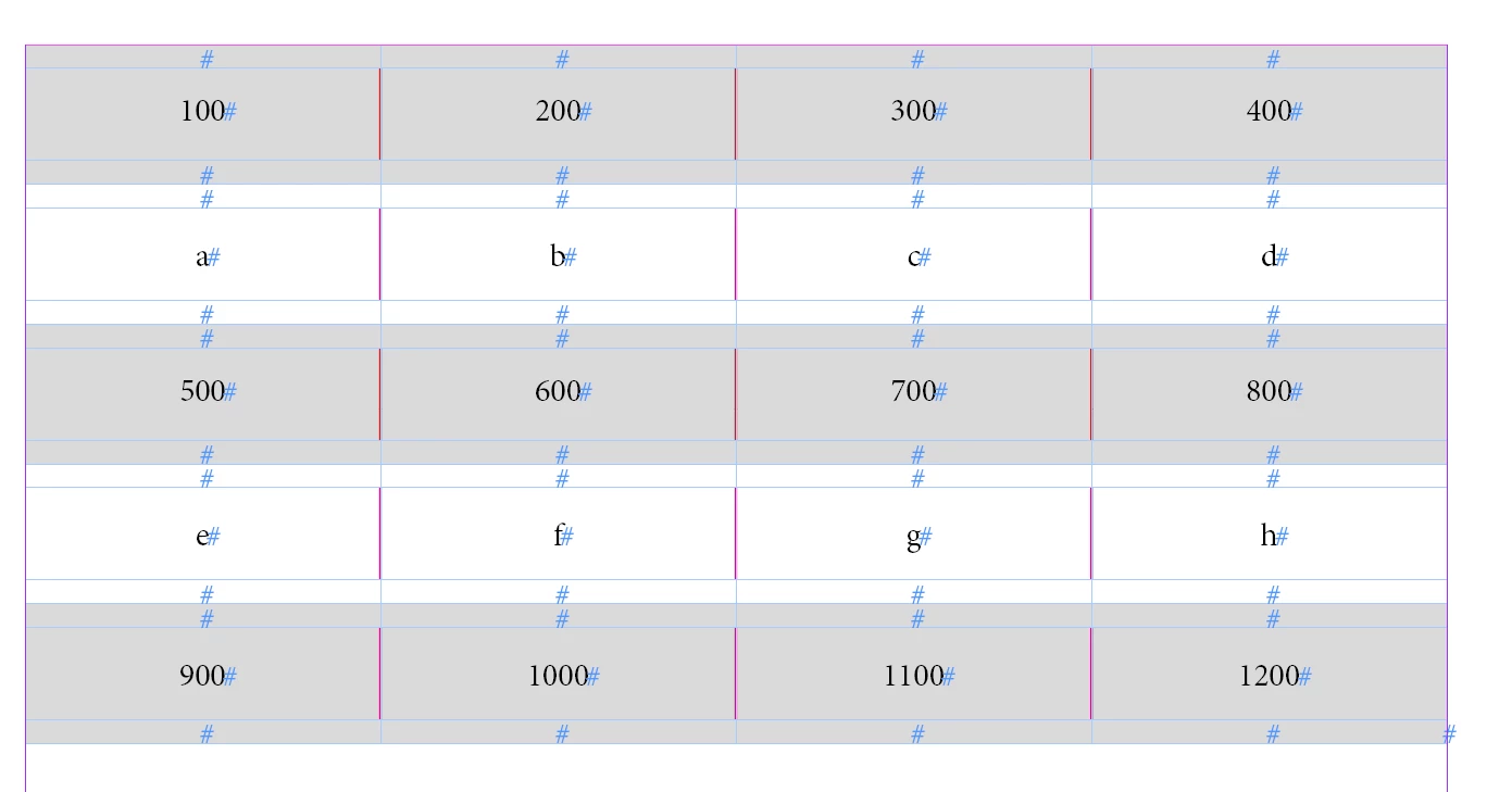

September 12, 2020

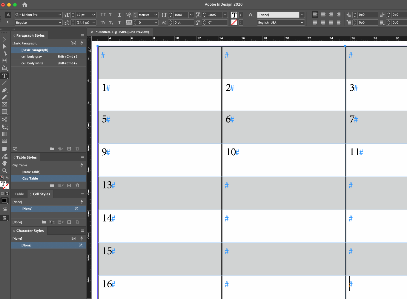

Hi Learizam:
I was able to accomplish it with two paragraph styles using both a rule above and below—different settings for the gray vs white rows. Below I am applying the gray values to the entire table, and than manually applying the white styles (including using a keyboard shortcut I assigned to the white style). If this looks like something you want to pursue, I'm happy to add more details.
~Barb

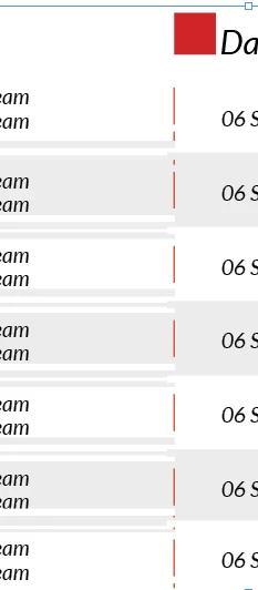

Dear Barb,
Thanks for your reply, I have tried this but I'm having a problem if the data is Two lines.  See below.\
