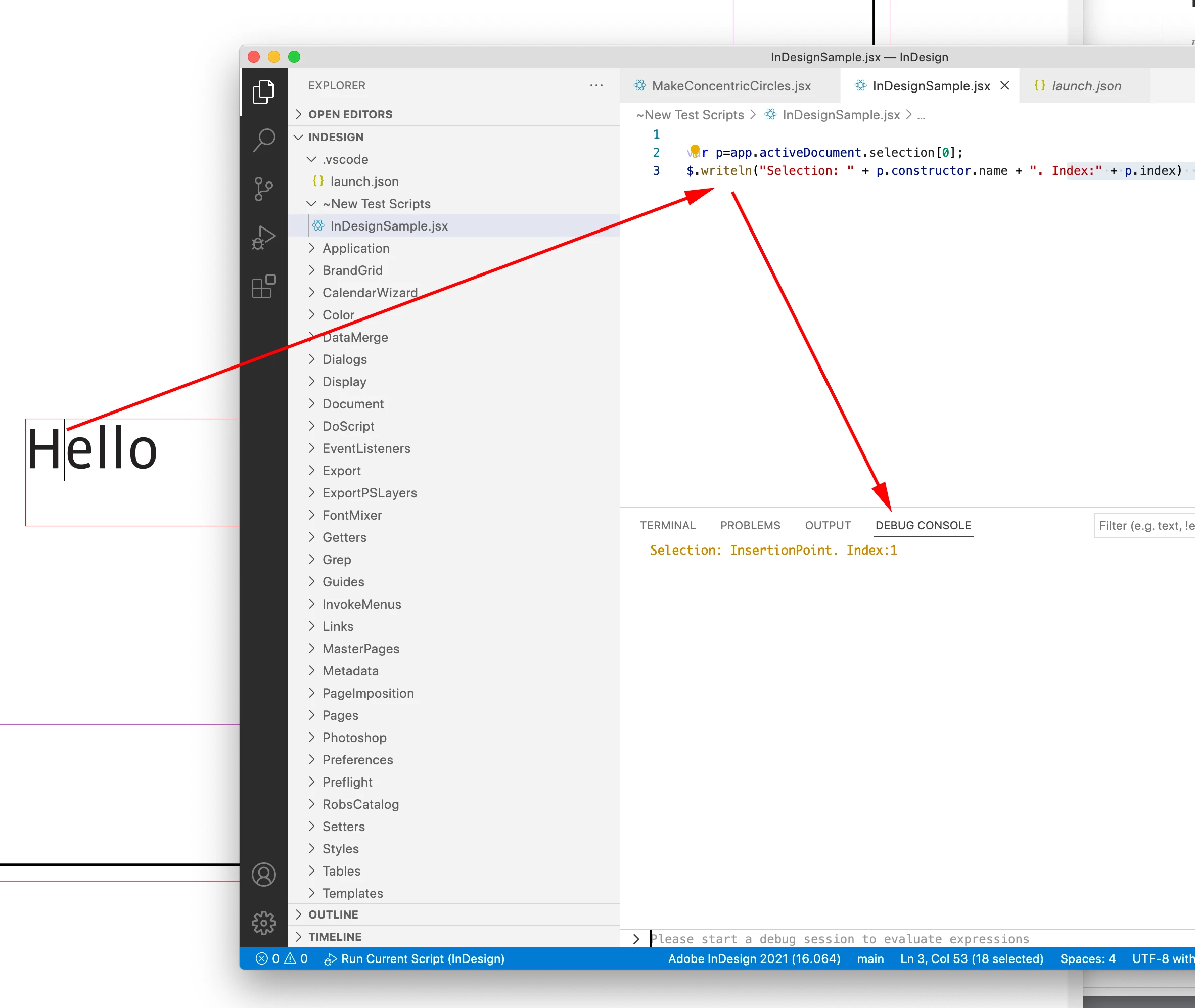

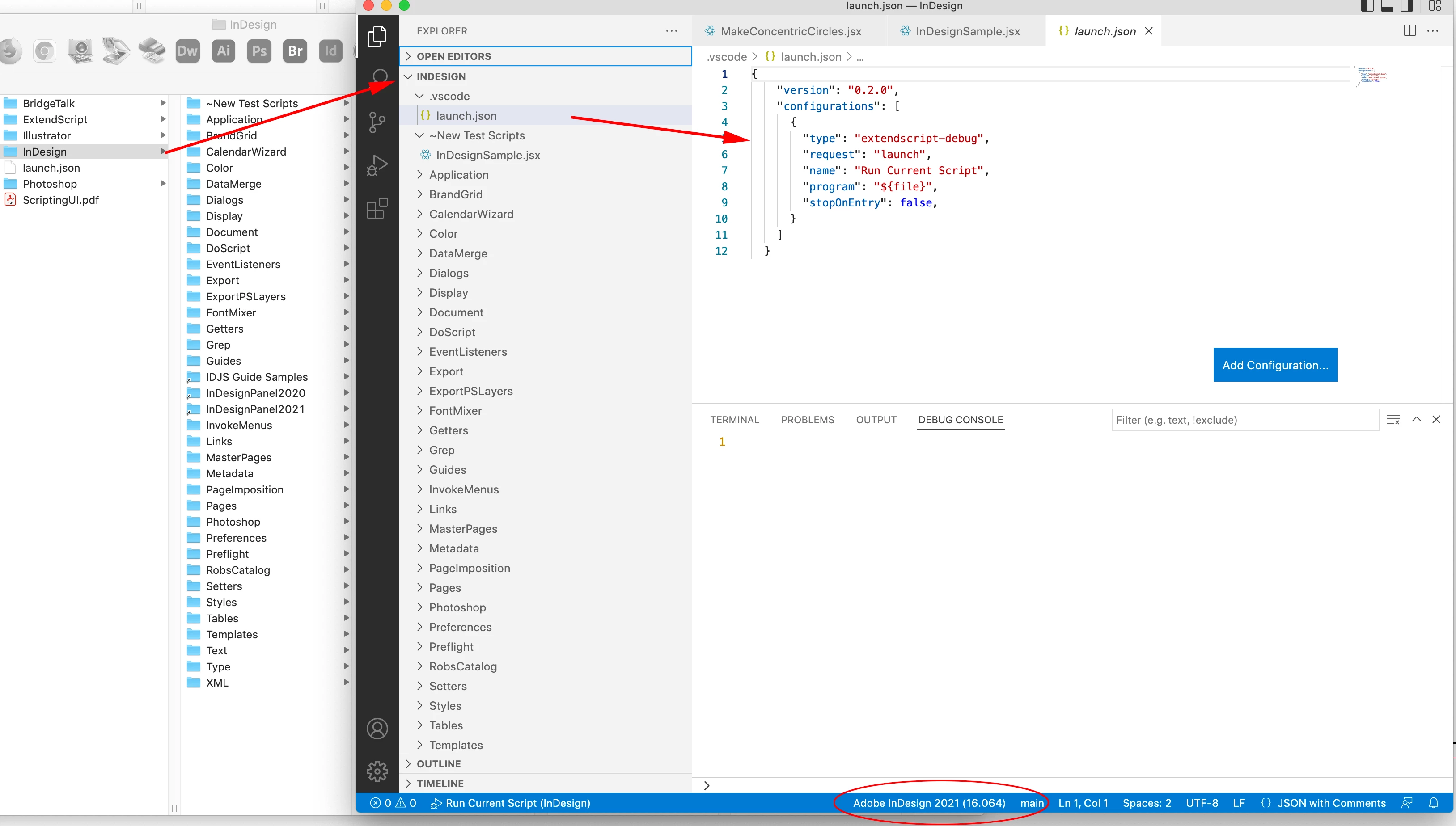

Hi @MrZZY , also, in case you haven’t done it, create a root folder for storing and editing your scripts, then open that folder via File>Open Folder. The first time you open a folder you will be prompted to create a json, that will be associated with the scripts in the folder. From the Explorer you can then make copies of templates or existing scripts by Option dragging or right-clicking a script.
To Debug you should be able to use the default F5 key, or from the menu it should be Run>Start Debugging (not Debug>Start Debugging. Here my selection is an insertion point and I can get info on the selection via $.writeIn() in the Debug Console

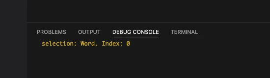

Hi @MrZZY, when you say the "hello world" alert was working—it made Indesign show an alert? If so, good! Your launch.json is okay. In that case just use $.writeln(myObject) in your code and run that script through the ExtendScript debugger—the same way as you ran the alert('Hello world') script.
As for the Object Model viewer of ESTK, that isn't working too well in ExtendScript Debugger 1.0 which you are probably using. They are working on a new version 2.0 that is much better but we'll have to wait for that. In the meantime, see what you can glean from the object model in this documentation. It lists all the objects and their properties.
