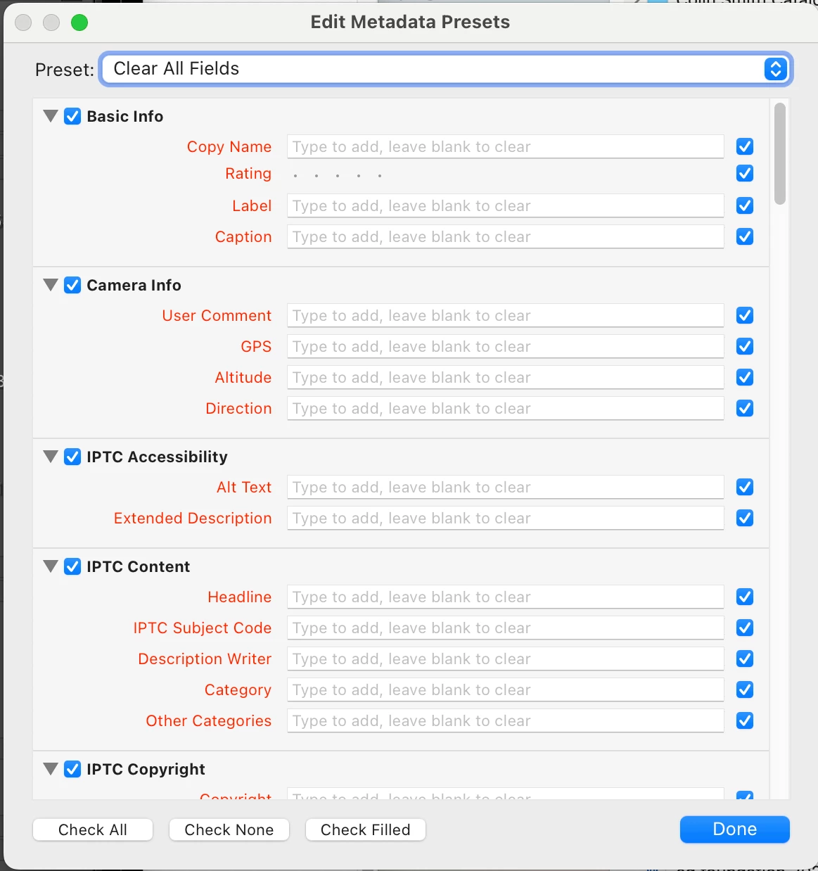

Yes, there is. Create a metadata preset where you check each field you want to remove, and keep that field empty. The caveat is that you can only remove added metadata this way, not embedded metadata like EXIF.

[This post contains formatting and embedded images that don't appear in email. View the post in your Web browser.]
Building on Johan's reply, here's a screenshot:

Thank you for your replies. However, from my testing, if the name of any field is in red, then the metadata preset will not run. Is your experience different from that?  In other words, if I select a field and enter “Dummy” data in it then the preset will run.  However, if I remove the data then the name turns red and the preset will not run.  My process to run them is as follows:
On the right side panel under “Metadata” select the drop-down arrow and select the preset you just created/On display, click the metadata icons and select “Save” This saves the changes to the hard drive.
