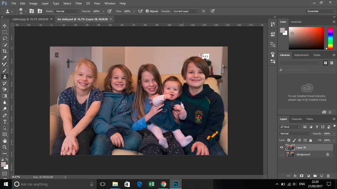

    Here is the photo, it is the tv I am trying to remove (its for a friend who wanted to frame it for someone so its not really necessary as its still a nice photo but they would prefer it without and I wanted to try and improve my editing skills, ive not done object removal before)
    So with the content aware at first it replaced it with some smeary hair and randomly an eyeball, and by creating another layer for the fill it blended the top of the cards into where we would like wall to be which makes sense if it uses its surroundings to fill it, thats why I was wondering if I was going about it the wrong way?
    davescm
    March 18, 2017
    Hi

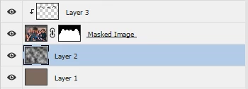

    The best way with that is to use select and mask to select the area you want - then drop in a new background behind it.
    Open the image and select and mask, set the view mode to onion skin and transparency to 30%. Now use the quick select tool (the brush at the top left) to paint in the areas you want i.e. the children & seat. If it it picks up areas you don't want hold the Alt key whilst painting and it will remove them.
    Once you have done that change to the refine edge tool (second one down) and set the brush to just 10px wide. Now paint around the edges of the hair (and only those edges)
    When you are done set the output (bottom right) to New Layer with Layer Mask and press OK
    Now you can insert a new layer underneath with whatever background you choose - I used a layer using Filter - Render - Clouds and  set to the luminosity blending mode over a brown layer.
    Finally add an additional layer above the masked layer - set the layer blending mode to colour and paint around the edges of the hair with a brush set the same as the hair colour. This just removes any fringes of colour from around the edge that had been picked up from the background.
    I hope that helps you
    Dave
    victoriah80830523
    March 21, 2017
    Hii,
    Wow thank you, that was really helpful, I managed to make the mask so I could sort the background out easier with the clone stamp without having to go round all the bits of hair etc in the way (that was really annoying before) then merged the mask back onto the background, although I need to improve my edging,I didn't really get the last part, but i don't think it looks that bad for my first attempt so thank you very much :-) I shall keep practicing now I have an idea what im doing
