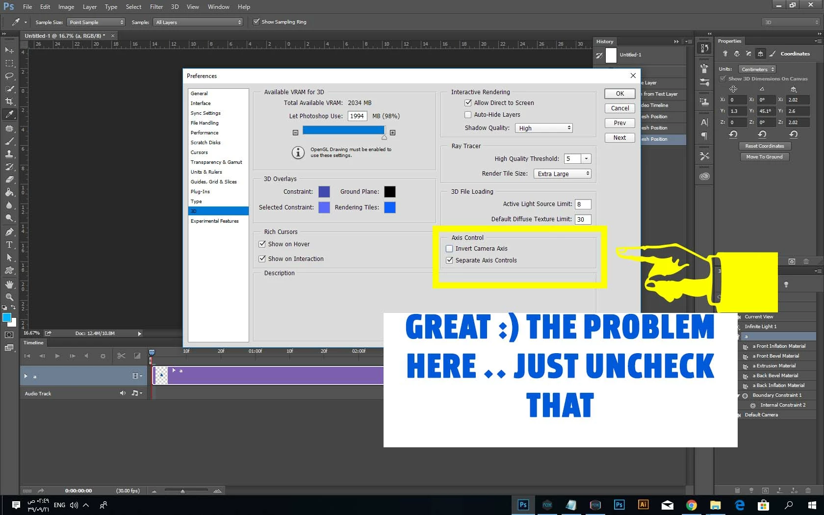

thank u davescm to your correct answer ,tanks  dramenon AND omar to your post ..

I'll change yours to be the correct answer . Although we were on the right lines with the axis controls,  I didn't realise that option was there . Thanks for posting back

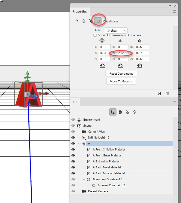

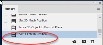

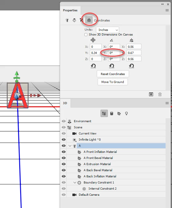

Looking at the history panel in your screenshot, it shows you have moved the 3D camera not the object. If you have rotated the object it would say "Set 3D mesh position" in the history panel.
Before:
After:
History :
Are you by any chance using the wrong widget - the one at the bottom left of the screen moves the camera, the one in the object rotates the mesh
