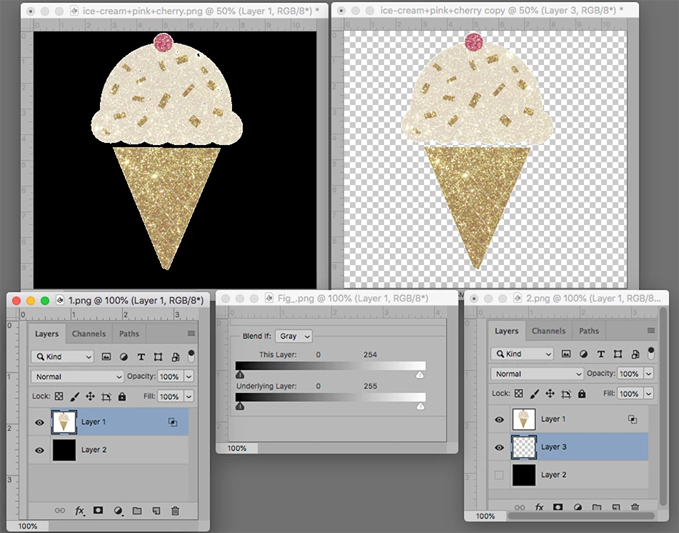

    Before suggesting a solution, a check was made to confirm that the white within the illustration was the same value of white as the surround.
    Placed a layer below the image filled it with black.
    Double clicked on the image layer to bring up Layer Style
    Moved the top right slider of Blend If to 254. Found the background was lighter than in image lightest value.
    Added a blank layer below the image layer and turned off the black layer.
    Deleted the black layer and chose Layer > Merge Down to complete the.composite

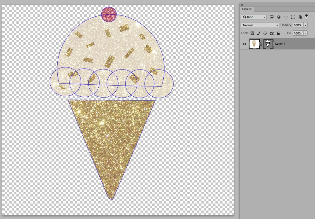

    A better choice would probably be a Vector Mask (created with the Pen Tool, Ellipse Tool,…).

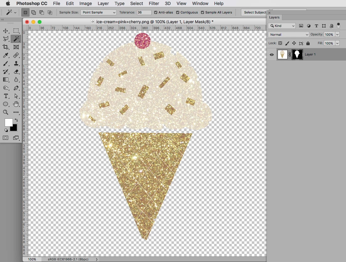

    c.pfaffenbichler
    June 8, 2019
    In a case like this even the Magic Wand Tool might almost suffice.
    Select the background, Layer > Layer Mask > Hide Selection.
    At the top right a part of the »ice-cream« is affected, that can be amended by brushing on the Layer Mask.
