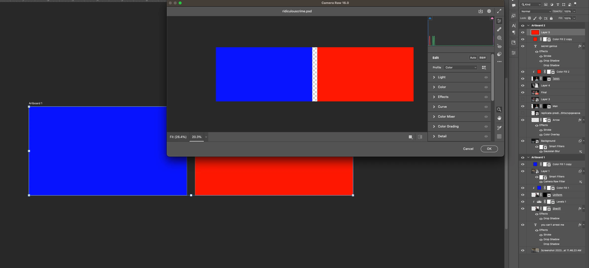

I have been facing the same issue past many days, I want to merge layers of a particular artboard and apply "camera raw filter" to only that merged layer.
But when I try to apply the vignette to that merged layer, it is only applied to one particular corner of the layer as it selects the entire area even if I hide the other artboards.

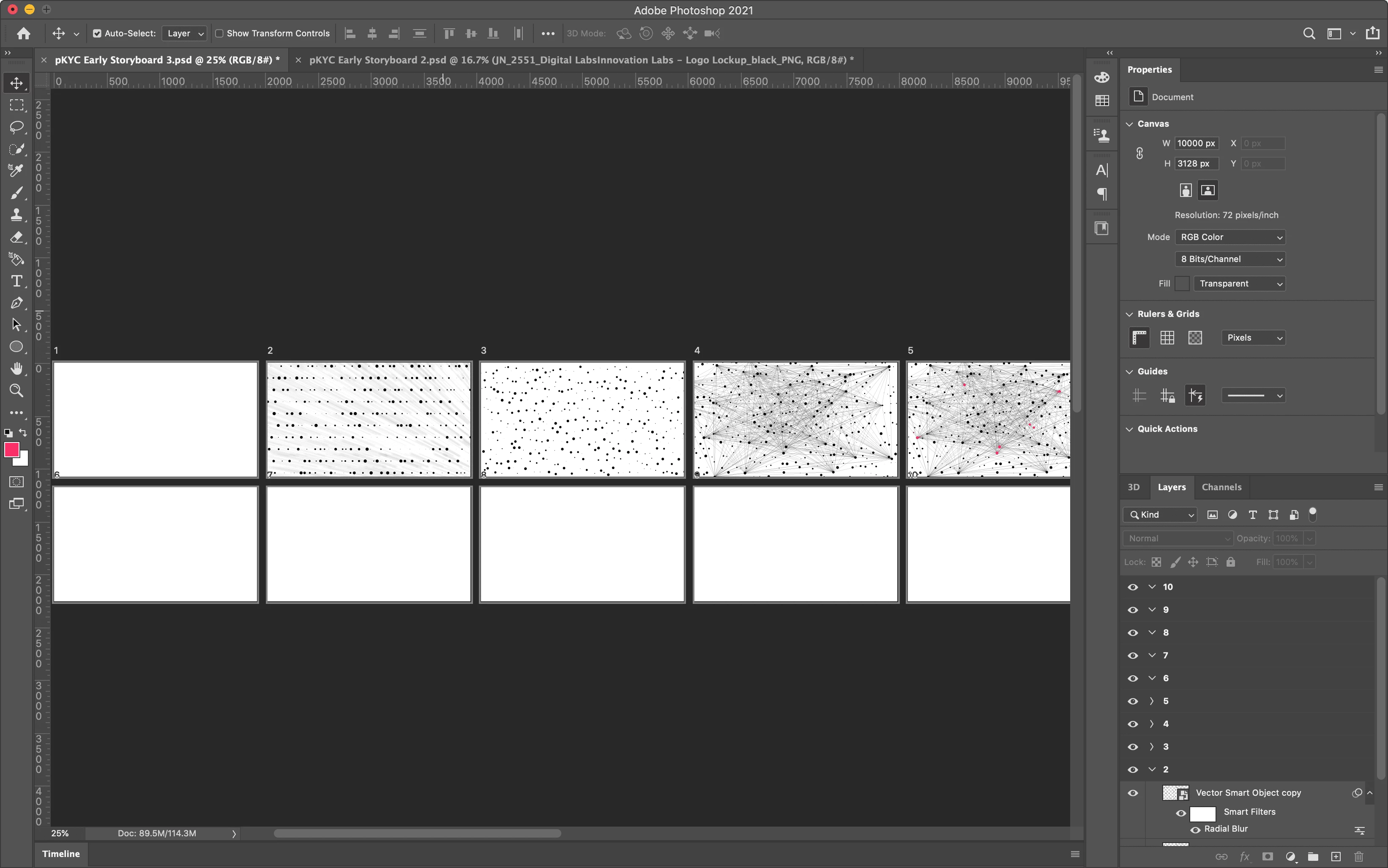

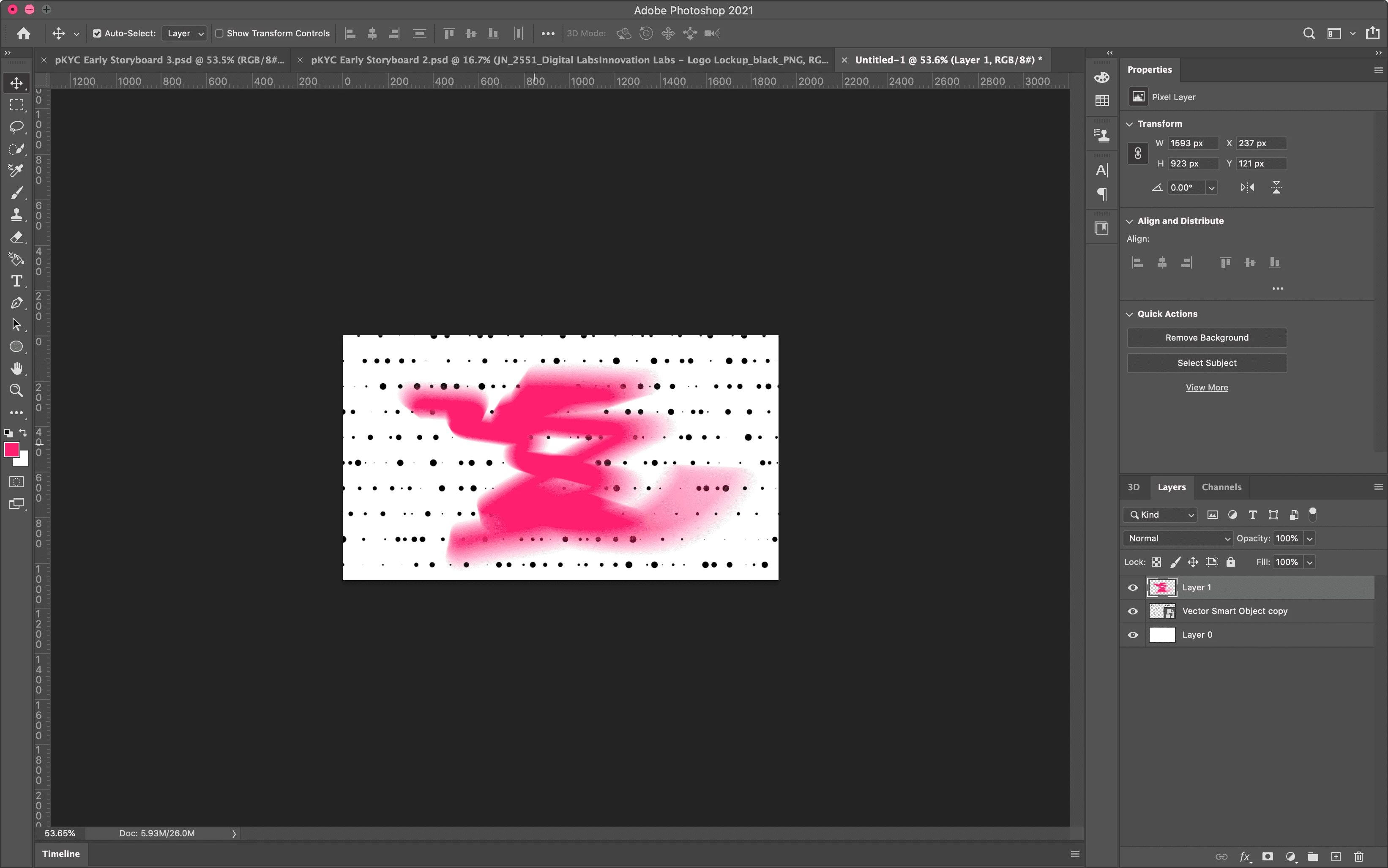

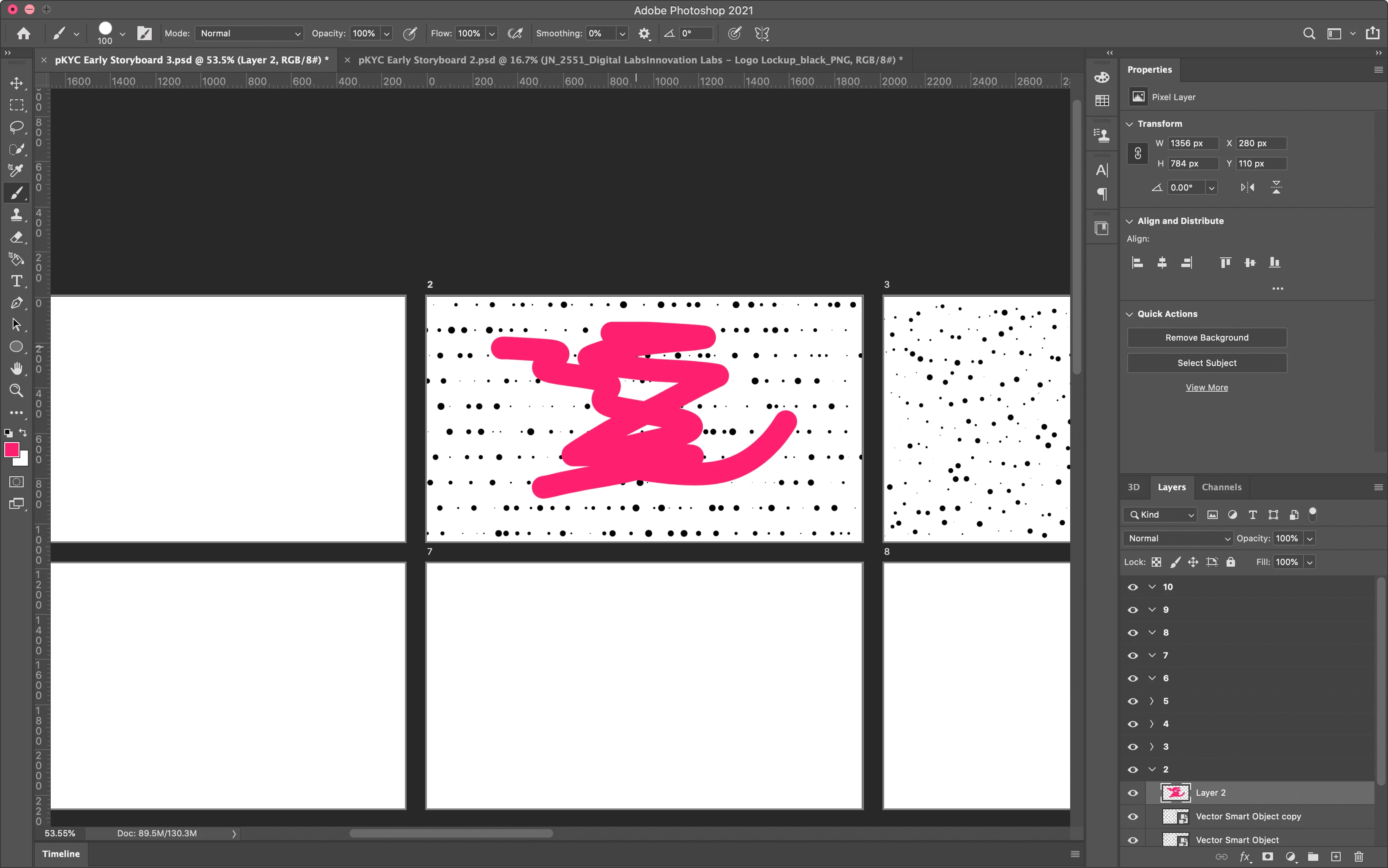

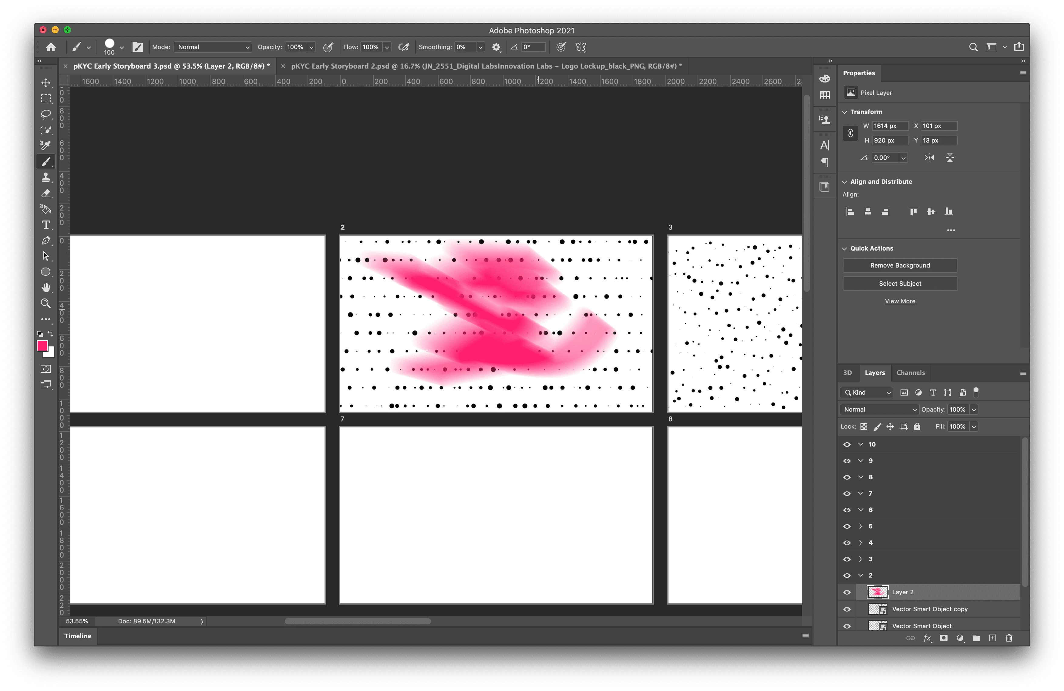

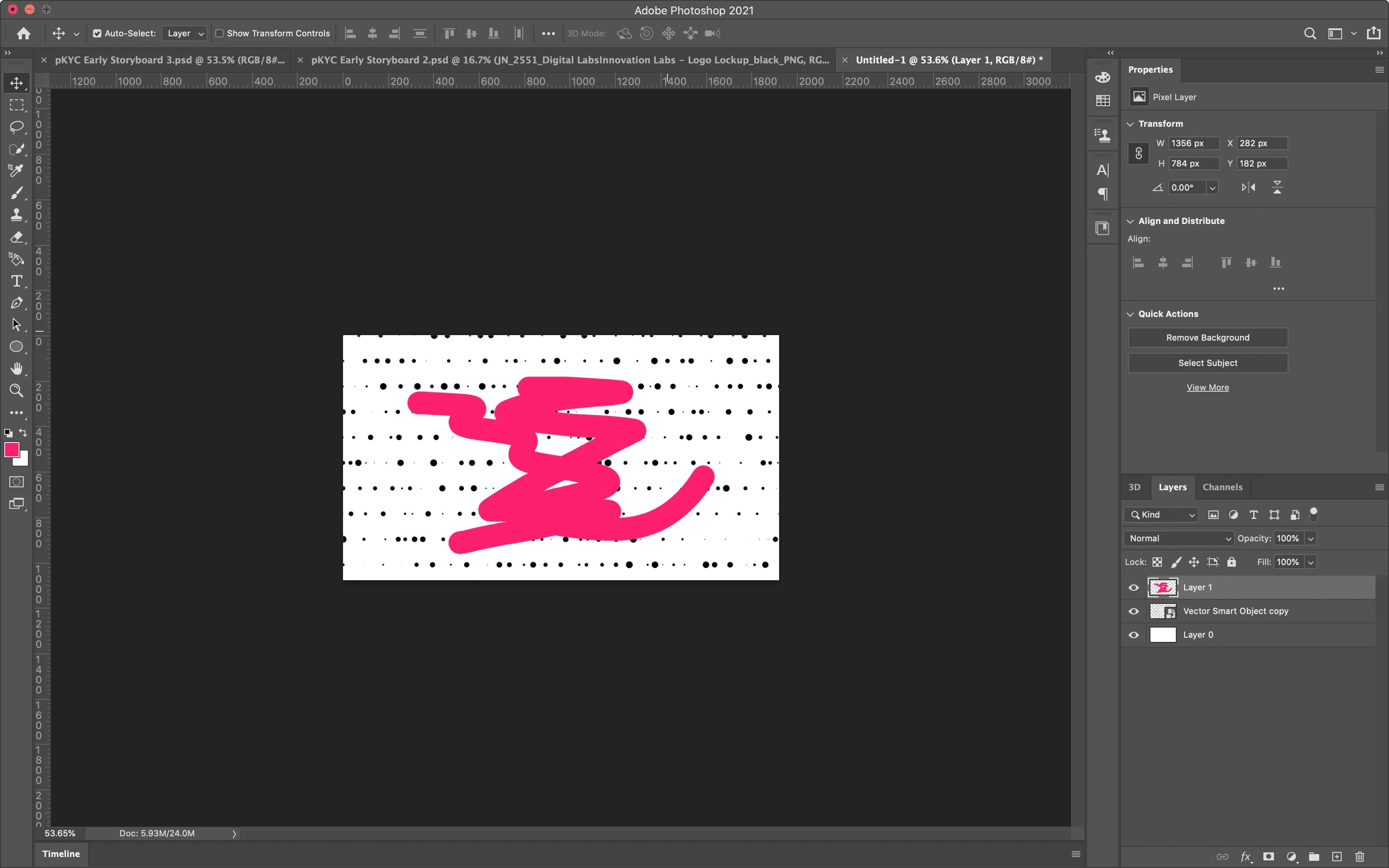

Sure. Here you go.
I have 10 artborts in current project. I added 1 new layer in 1 Artboard. Some brush strokes to help it visualise it better.

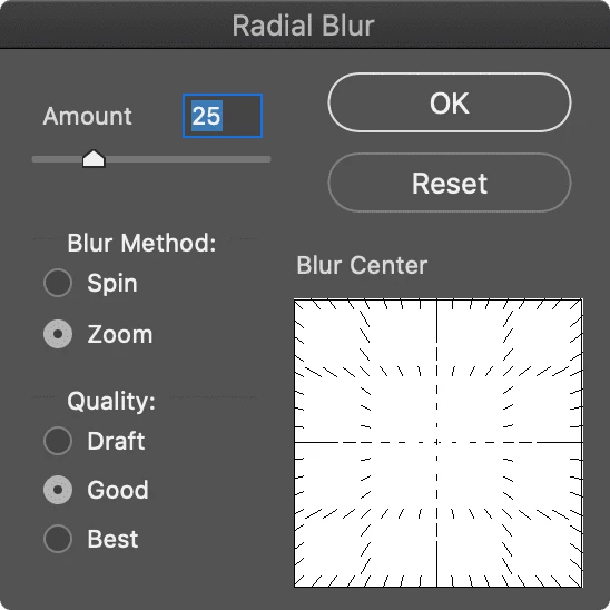

After I run Zoom Blur, it applies filter from the centre of all the Artboards? At least it looks like it to me?
January 14, 2021
Just to claryfy - I want Radial/Zoom Blur to be applied to layer directly in the Current Selected Artboard Space (if there is such term?).
For example, if I have only 1 canvaas, Blur looks like this:
January 14, 2021
