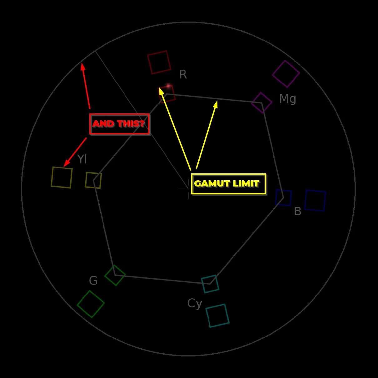

1) Color gamut, how to interpret oscilloscope, or the scheme of the allowed limits, as evident from the image in the first grid there are the imposed limits not to be exceeded, but what do the second (squares and lines) indicate?
2) how to keep the "bright" colors with the Color correction because to fall within the color gamut parameters the colors are very dull.
Thanks to whoever disappoints me.

The Vectorscope is an awesome tool, it's the best way to check that your neutrals are actually neutral, for instance. Plop an opacity mask on your image so only a fairly neutral area is showing, and see where the trace in the Vectorscope is lying. You can then adjust the colors or color balance to get your neutrals ... neutral.
And for what you're seeming to want to do, it's also very useful. That roughly hexagonal box is always the allowable broadcast standard limit for the color space of the sequence. And of course, the limit varies by the color space of the sequence. In Rec.709, that limit is for the sRGB color space. If say HLG, that limit is (within Pr) defined as the Rec.2100 color space, which includes many colors outside of sRGB.
If you are working for broadcast, you must stay inside that hexagonal shape.
If you are not creating for broadcast use ... well, whatever the limit is, that's up to you then, innit?
The outer circle is just the edge of the scope. Irrelevant to use.
Often you'll have one or two hues pushing towards the edge with a lot of the rest of it fairly low saturated. By seeing where you are having sat spikes, you can go to the Curves tab, the RGB Curves section, and use the Hue vs Sat tool to fix that.
Set a control point (by clicking on the line) in the midst of the hue range that is 'hot'. Set a couple more a bit on either side. Now move that first one down, so that the spike isn't as spiked. You may choose to adjust the position of any of the three points for smoother work of course.
Now you should be able to bring overall saturation up a lot more without over-pushing any one color. And get more 'colorfulness' across the image without spiking any one color to blow out on a monitor or screen. Which never looks good.
