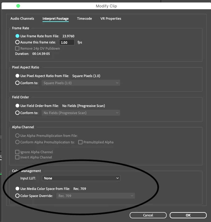

just a shot in the dark, but see if your footage is something different from rec709.   I went thru a lot of craziness with material shot on a sony camera (not sure which one) which was solved by selecting the clip(s) in the project, right clicking and choosing modify: interpret footage:  color management: and if it's not rec709, enable color space override to rec709.  Worth a shot.  Also which version of Premiere are you using.  The last few years of updates have vastly improved proxy workflow.  Used to be a serious issue with many sony formats.  Also, if you can manually create lower res proxies, you can unlink to the camera original and relink to the lower res files for your edit and then relink to the camera original when ready to output.  Not ideal, but it does work...  at least it worked for me when Premiere was unable to create attachable proxies with sony material because of some sort of proprietary format for the 8 channels of audio.  Let us know if any of this helps...
