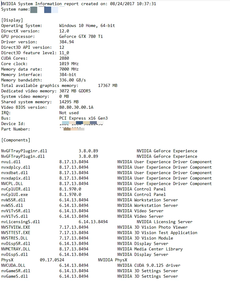

    Huck_Norris
    Huck_Norris作成者
    August 28, 2017
    I have premier set to use GPU acceleration CUDA.
    R Neil Haugen
    August 28, 2017
    Have you checked manually to see if that is the most recent driver for that 780TI card?
    If it isn't, do a manual updated of the video driver. If it is, try rolling back a driver.
    Also, for a test, set Mercury Acceleration to Software Only and see what you get.
    Neil
    Everyone's mileage always varies ...
    R Neil Haugen
    August 28, 2017
    What is your hardware ... OS/CPU/RAM/GPU/vRAM, and your video settings for Mercury acceleration?
