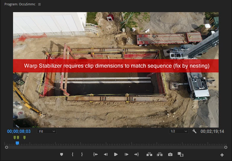

May 13, 2018
I nest then add the Warp and it seems to stabilize but then when I play my video over that clip, there is a red box over the video saying "Warp stabilizer requires clip dimensions to match sequence (fix by nesting)".   What a cluster.. I've already nested it and added the warp stabilizer and it still says this.
Ann Bens
May 13, 2018
Warp might be still applied to the original clip (before nesting). If so: delete effect.

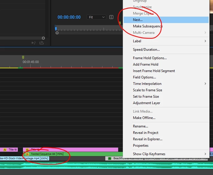

April 15, 2018
Click right button of mouse on a video sequence and there will be option Nest... See the picture.
After nesting the color of sequence will be green. Enjoy!
