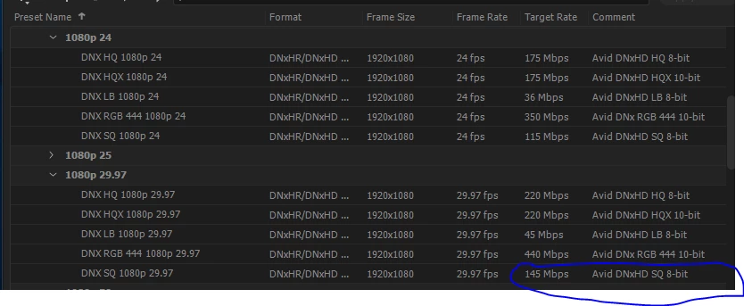

In the Premiere CC 2015 there was a codec called DNxHD145.  I used this to export a TV series for PBS.
Now I am exporting season 2 in CC 2017 and the codec doesn't exist.  Instead there is a HQ and SQ.  I assume one of these is really 220 and the other is 145 and they are just mislabeled. DNxHR (notice the R and not a D) HQ and SQ are new codec for UHD and I assume that is where the confusion came into play. I was in a chat with an Adobe Rep who basically told me to try my luck on here to see if anyone could help.  After doing some tests I think SQ might be the 145 equivalent but I would like to know for sure before wasting my time on exporting and shipping the wrong codec. Maybe DNxHD SQ isn't even the same codec as Avid's DNxHD codec.

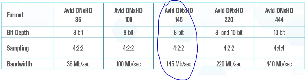

Here is a link to the Current DNxHD whitepaper as of the writing of this post.
http://www.avid.com/~/media/avid/files/whitepaper-pdf/dnxhd.pdf?la=en

I'm glad I'm not the only one that was scratching my head over this one - I was trying to find this out a couple of weeks ago.
I used the white paper :
and matched it against the codecs in Adobe Media Encoder preset browser :
There are six in the Avid list (2bit depths for 220)  - and four in the AME list. Between the 24 frame and 29.97 frame information there is a match of sorts for all except DNxHD100.
So I think you assumption looks correct

I did not see the bit rate listed in the export settings.  I did find a file that I exported last year.  The DNxHD 145 file had a bit rate right around 149mbps(video +audio).  I exported DNxHD HQ and it was around 224mbps and then I exported DNxHD SQ and it was around 224mbps. So I believe that DNxHD HQ is DNxHD 220 and DNxHD SQ is DNxHD 145 and Adobe just has them labeled incorrectly. DNxHR is there new UHD codec and it uses HQ and SQ as labels but the DNxHD still uses 220 and 145 as labels.  I hope everything is compatible because this is going to be played off a Grass Valley server that can only play a limited amount of formats.
