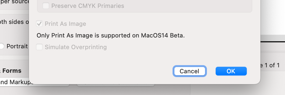

New Here ,
Apr 10, 2024 Apr 10, 2024
I've got the same problem here (in France)... is somebody working on it?
I've just downloaded acrobat in order to use this tool and I'm very disapointed that it can't work on MacIMG_3320.jpg
