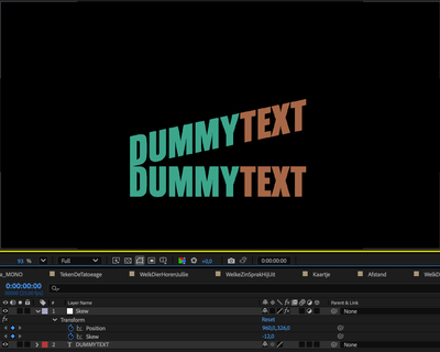

Using an Adjustment Layer to distort underlying layers, e.g. Position and Skew (Screenshot 1), when rendered to RGBA with a Straight alpha, shows a strange behaviour in the RGB channels: both the original and the distorted underlying graphics are included (Screenshot 2). This seems like an unitented render behavior to me.
Screenshot 1 (RGB with Alpha applied)
Screenshot 2 (showing RGB Straight. without Alpha Applied)

Hi jaydude-wb,
Thanks for reaching out. It does look strange! I just gave it a try as per your description, but it worked as expected. Do you mind sharing the project file and the exported file so that we can try to replicate the issue on our end?

Hi @Jaydude-wb I was actually able to reproduce this issue and I've filed a bug linking to this forum post. Thank you for the report!
- David, After Effects Engineering Team
