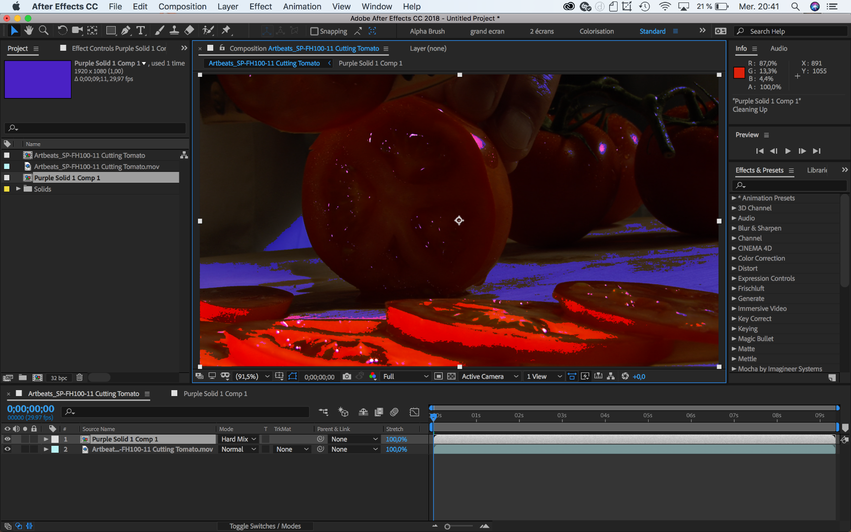

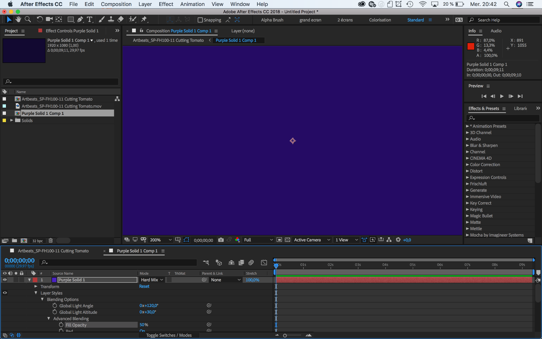

Thank you for your quick answer, sorry that I couldn't reply sooner. Unfortunately even though I tried  a lot of different ways and alternatives, it didn't seem to work at all. Whether I put the blending mode on a solid, psd file, adjustement layer, ANYTHING, I can't seem to be able to achieve the fill opacity effect. I put screenshots just in case it may help. Do you have any other ideas why it doesn't work?
Capture d’écran 2018-07-18 à 20.41.25.pngCapture d’écran 2018-07-18 à 20.41.30.pngCapture d’écran 2018-07-18 à 20.42.12.pngCapture d’écran 2018-07-18 à 20.42.06.png
PS: Im not sure if it's normal or not, but if I want to put a blending mode and layer style on the same layer, im obligated to put the layer in a precomp. If not, blending mode doesn't work with layer style on the same layer.

I see you found the answer on the COW:
CreativeCOW
the project setting was set to 32bpc and that disables this feature apparently. So the COW wins on this one!
