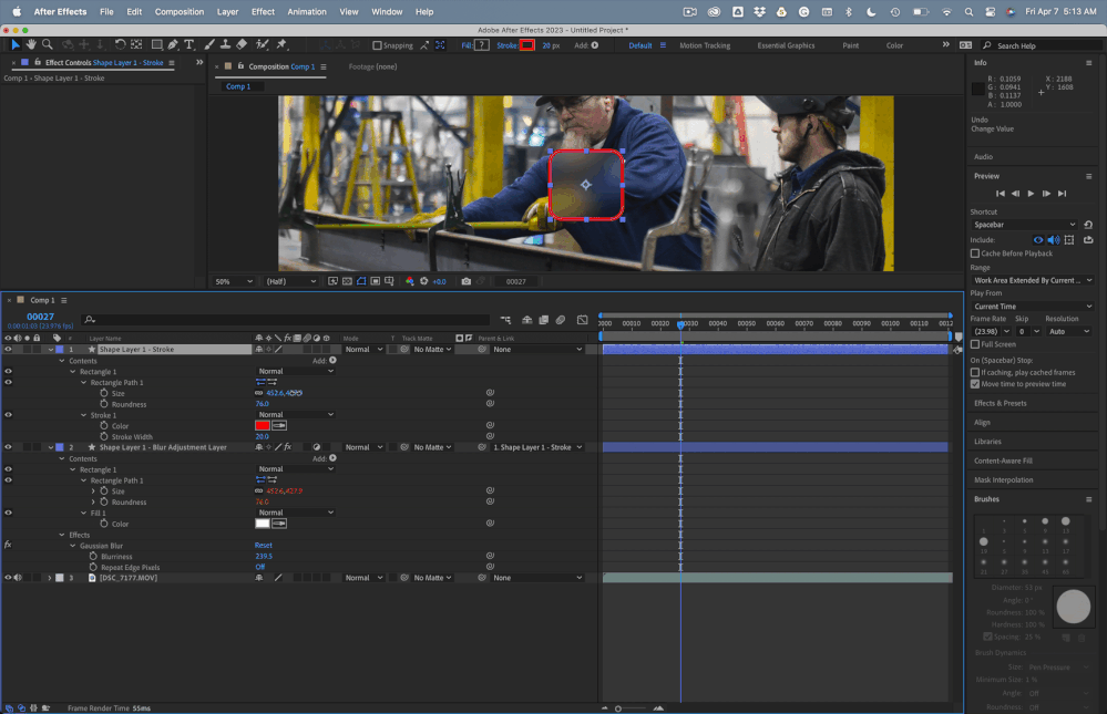

If you put a mask on an adjustment layer, add Gaussian Blur to the Adjustment layer, turn off Repeat Edge Pixels, then add Stroke and use the mask for the stroke, you will end up with a blurred area that fits inside the mask that has a stroke around it.
Most of the time, using adjustment layers in a composite is a pretty bad idea because it affects every layer below the adjustment layer, but if you want to blur everything below the adjustment layer, adding a blur to an adjustment layer with a mask or even adding blur to a shape layer and setting the shape layer as an adjustment layer would be a decent approach. The only problem with using Stroke on a mask is that Stroke is only an 8-bit effect.
I would probably use a shape layer to create the stroke and put a duplicate of the shape layer below it, and set that layer as an Adjustment layer with Gaussian Blur added. If you worked that way, you would not have to turn off Repeat Edges, you could work in 16 or 32-bit projects with no color problems, and shift + parenting the shape layers together would keep things lined up if you needed to animate the effect.
Participant ,
Apr 07, 2023 Apr 07, 2023
Yes that is the effect as shown in your screen capture. Thanks a lot for pointing it out.

Just now added a fresh adjustment layer. Made it small on the comp like a stamp. Right clicked on it and selected Layer Styles > Stroke. A landscape photo is below it on the comp. Added effects to the layer and tried....., removed all effects and tried, try what not.....the border just doesnt appear at all on the small adjustment layer. I dropped a small jpg of small size on the comp and tried the same layer style method and it works. It seems like it doesnt work for adjustment layers ?
Use a shape layer or a mask and stroke on a comp sized adjustment layer.
