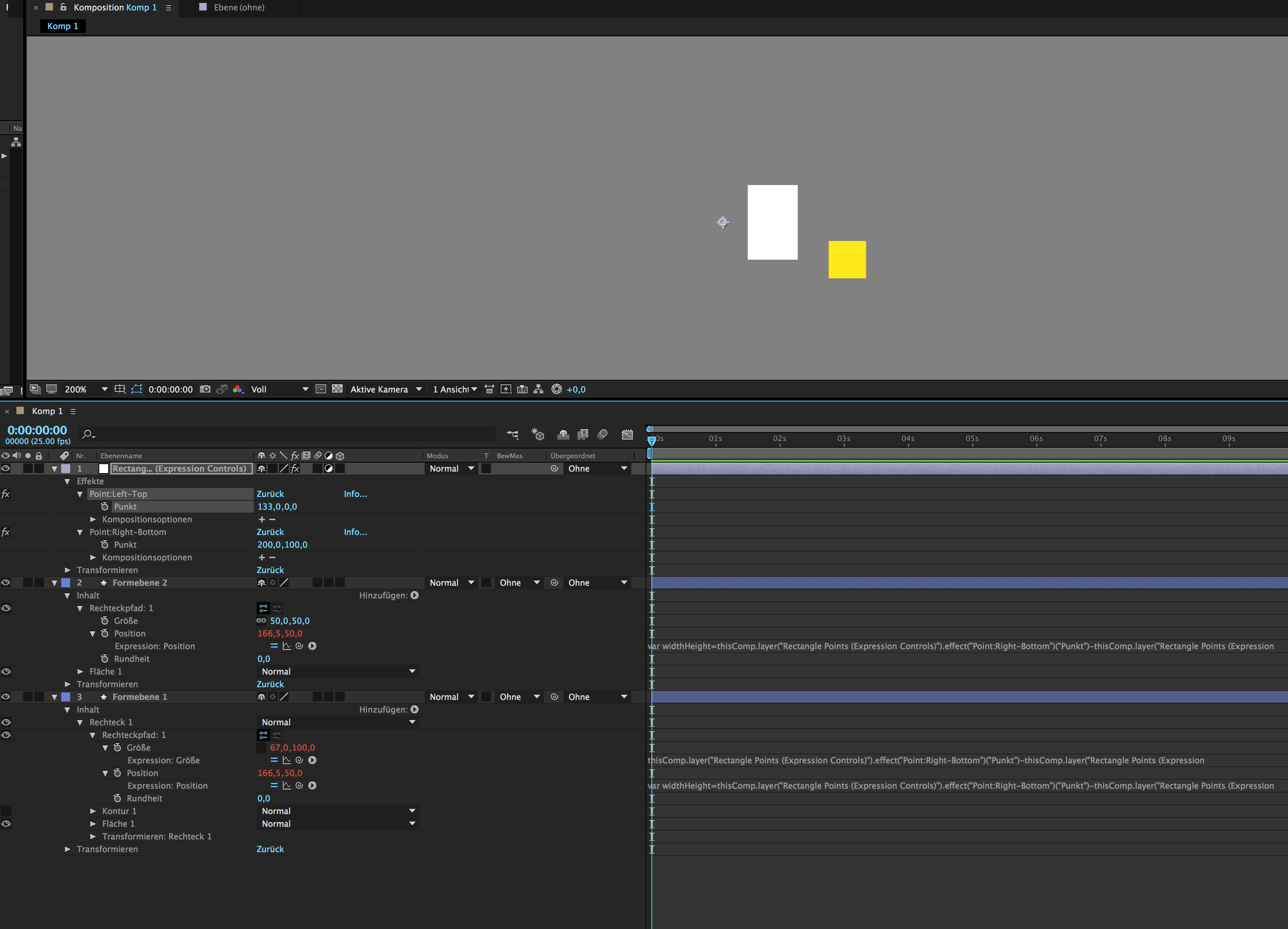

i tried your method and it worked. But i'm not sure if it's the solution for my problem.
Here are Screenshots from my project:
1. 2.
3.
Here you see the 4 edges (yellow) and the rectangle (dark grey). When the edges change their position, the rectangle shall change its scale according to those positions. In the moment it is just another layer lying underneath them. My wish is that i can change the positions of the upper right und down right yellow edge and the rectangle automatically changes too.

Unless I'm missing something in your requirements you can fully describe the position and scale of your rectangle with only two points (upper-left, bottom-right), which is why I used only two points in the sample expression I provided. So in your application you can just ignore the bottom-left and upper-right points when using the expression.

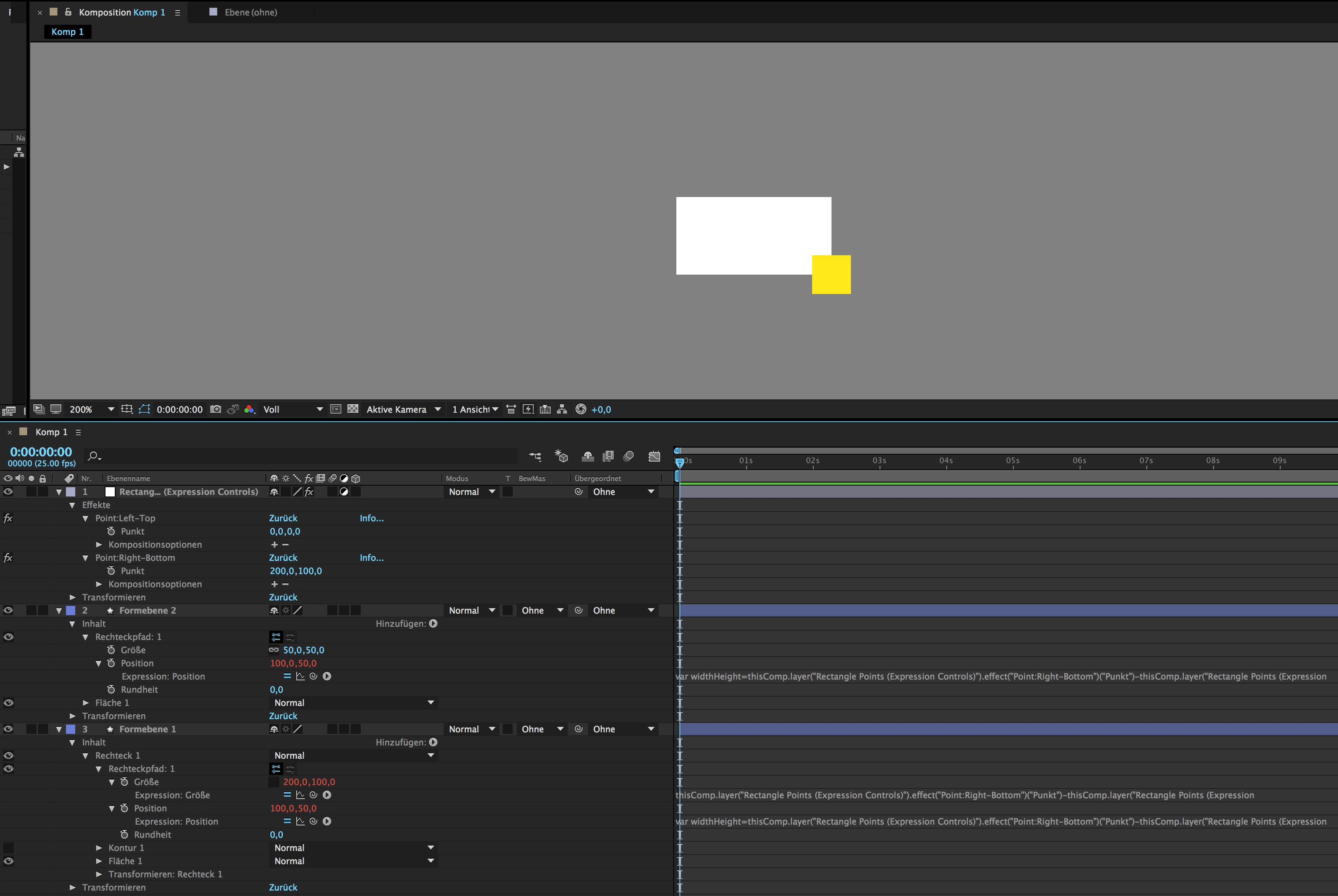

Now what do i have to do, if i want to link the yellow edges to the edges of the rectangle?
I tried to use the same expression for the position i used for the rectangle (without the scale expression). but thats not working the way i want it its moving in the right direction and all. but its not really attached to the rectangle.

Make sure your yellow rectangle's layer's transformation position value is [0,0]. And the shape group's too.

the bottom left one is stuck! like i want it to be. but i have a problem with the bottom right one. its moving correct in the x coordinate. but when i change the y coordinate its moving (still up and down) but inverted. like when everything should be moving downwards the bottom right one is moving upwards. but the bottom left one is moving like it should.

okay i think i know why. those yellow edges i showed you before. i created just one and duplicated that one and changed them by rotating them. i rotated one of them like the bottom left one (the first i created) and know they are moving correctly.
it was my fault ^^
