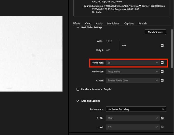

for mediaencoderfor mediaencoder

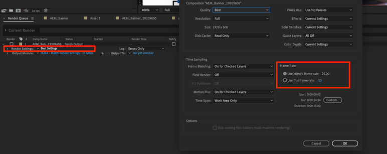

 Hi Ashuu, did you try these settings under the render queue and media encoder to change the frame rate? Have marked in red box for your reference.
for render queuefor render queue
