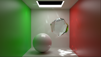

I've made a test render in C4D using Redshift. The render is stored as an EXR file with ACES-cg as the colorspace.
When I import this render into After Effects and apply FNord's OCIO plugin everything works great.
It's set up according to the instructions on the Redshift site:
https://docs.redshift3d.com/display/RSDOCS/Compositing+with+ACES
The image looks the same as in my C4D renderview. See below:

I would expect the render that is now interpreted as an ACES-cg render to look the same as in my C4D renderviewer or using the OCIO plugin. Instead it looks like this:
The transfer curve seems to be different as the image is much brighter than what I would expect. The brightest parts are completely blown-out.
Where am I going wrong? Why is there a difference between the two methods? Is there a way using the built in colormanagent to get my render to look the same as it does in my C4D renderview?

And a side by side so it's easier to see the difference 
