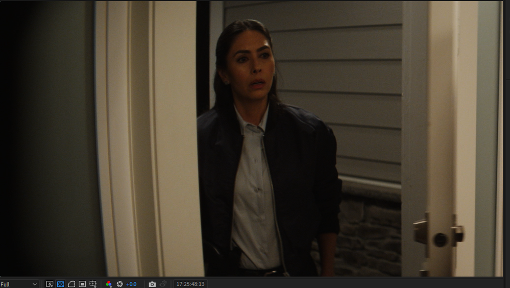

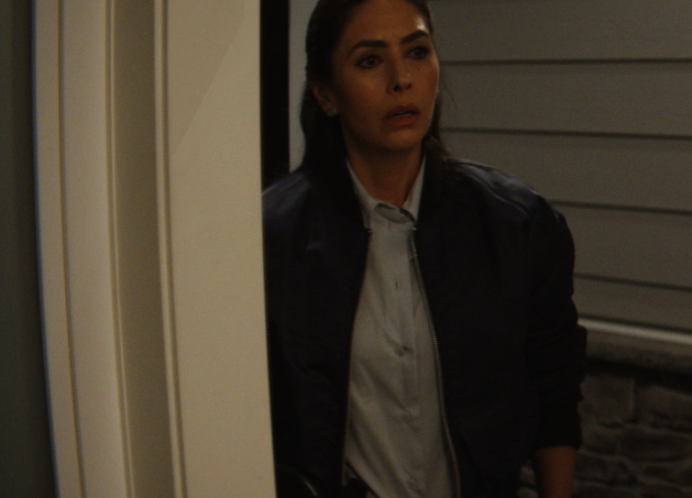

Hi, I am currently using After Effects 22.4. I need to remove a boom shadow on the door frame in a shot with some slight movement. In the past I would just painted it out with the clone stamp and then parented it to the tracked movement. Having seen the results on YouTube videos of Content Aware Fill, I decided to give it a try. I have attempted different settings for 2 days now. The fills are always smudgy and blurry on such a smooth and evenly lit surface. And it failed to reproduce any edges - a fin-like pattern of lines are created instead. When I masked the area as multiple patches of similar paints with no edges or lines, they still look low-resolution and smudgy and noisy. And the tone is always darker in the top half within the fill.
The project is set as 32bpc, and so is the Content-Aware Fill settings. A frame right before the shadow comes in is set as a reference frame. Masks are feathered between 8 and 14%; Alpha Expansion between 5 and 10. Object as the Fill Method seems to have the better results, same goes to transparency grid for the masks. Light correction was tried - Moderate has blended in the fill better than Slight and Strong.
The tutorials I watched have accomplished way more complex shots in great results. I am sure I am just missing a simple step or setting here or there. Can someone point it out to me, please? I have attached the reference frame and some of the better results here. Screenshot 2022-05-19 141620.pngScreenshot 2022-05-19 141431.pngScreenshot 2022-05-19 140705.pngScreenshot 2022-05-19 140442.pngScreenshot 2022-05-19 140604.pngThank you!

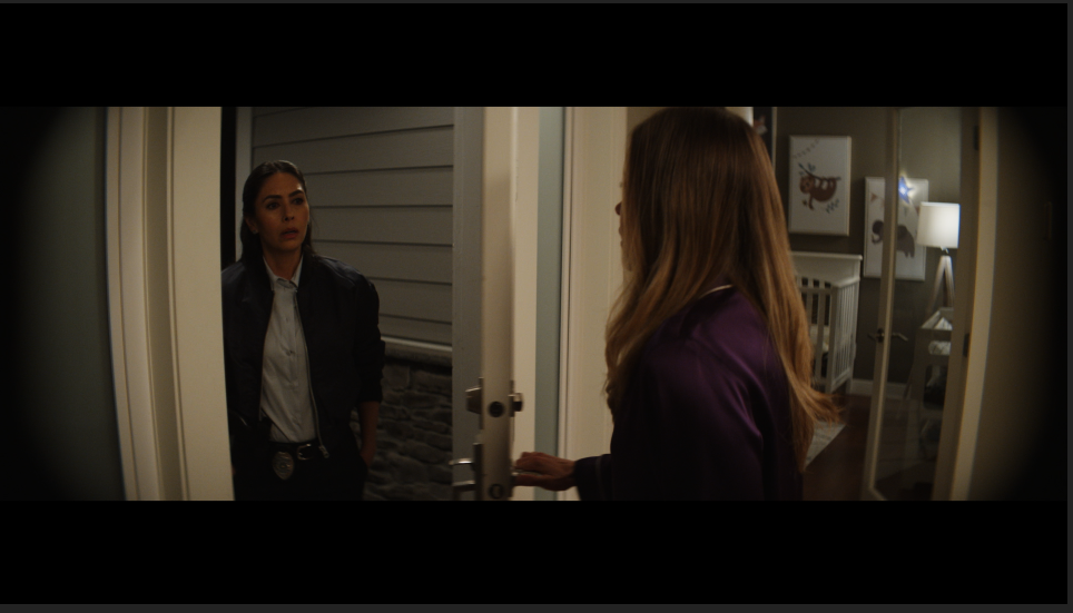

I should clarify a little - The first picture I attached is the clean frame before the boom shadow, and was used as a reference frame to generate the fill layer. The framing then stayed the same throughout. The other screengrabs are cropped out in order to show the issues clearer.
Below are the actual shots in full frame (the reference frame before the boom and the one afterwards with the fill layer).
The way you described is pretty much what I would do previously. From the demonstration/tutorial videos, I was just amazed by the capabilities of Content Aware Fill and how easy to use. I was hoping I could learn a new way that's all. But thank you nonetheless.Screenshot 2022-05-19 210131.pngScreenshot 2022-05-19 210441.png

Actually the shadow does not appear on the door itself as it happens after the door was opened. It’s just the part of the door frame that I circled in the earlier pictures. And as you can see there is very little camera movement and no obstruction over that area. For a pretty straight forward clip I just couldn’t get the results I want with various settings. There is always a grey blob floating around. And those were the best results LOL!
I agreed that Surface should have been a better setting but the full looks more glitchy and smudgy for some reasons.
