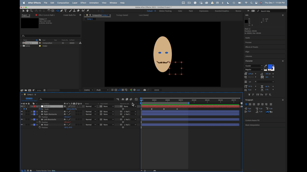

Dec 06, 2022 Dec 06, 2022
Hi Rick,
thanks for your time, ive solved the 0,0 issue with a easy animation preset linked to a kbar button.
Here is the setup which explains the rig a bit better. Im using shape layers to shrink the layers as they rotate on the x axis. all layers are attached to a main null head rotate. The moustache is broken into Left and right and has a axis at the center of the nose and then they bend on a Y rotation as the head turns right.  All duik connector expressions for each property. came out great 🙂 hope this explains the setup better and maybe helps out someone.
