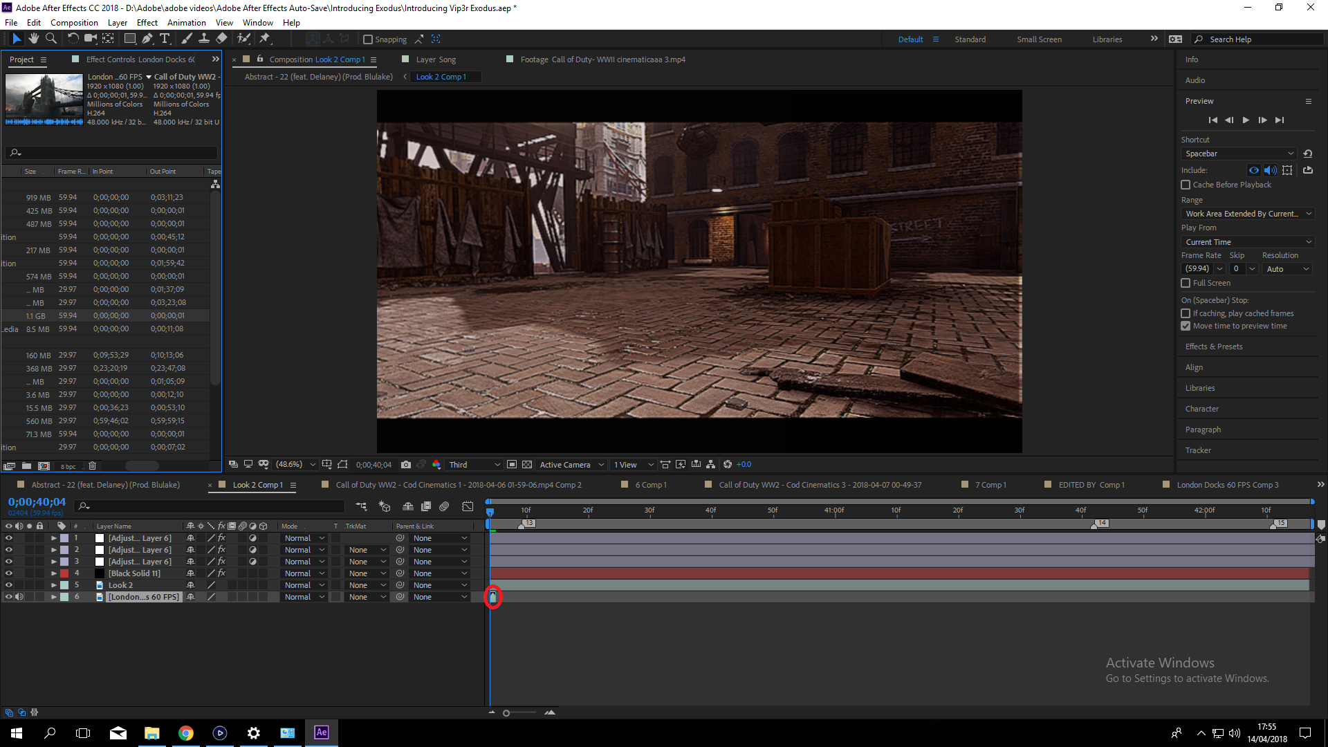

I had a licensing error on after effects so I decided to Uninstall and reinstall the program mid project. It was all working fine until I reopened my project on the newly installed after effects and the videos in the compositions I made either completely disappeared or is stuck on one frame. This is really frustrating as I spent days on this project so far.
Any help is really appreciated.
Thanks
Edit: I've actually researched this a bit more and it turns out after effects is turning the imported clips into only 1 frame long, while the video i import is actually 2 minutes long?! I've tried it in several different projects but the same result each time.
Please help with this

I was thinking it was something to do with that but, The project was saved before I reinstalled after effects and once it was installed I opened the project without changing any settings and most my videos were set to "Duration 00:00:01" Would this be something to do with an update?

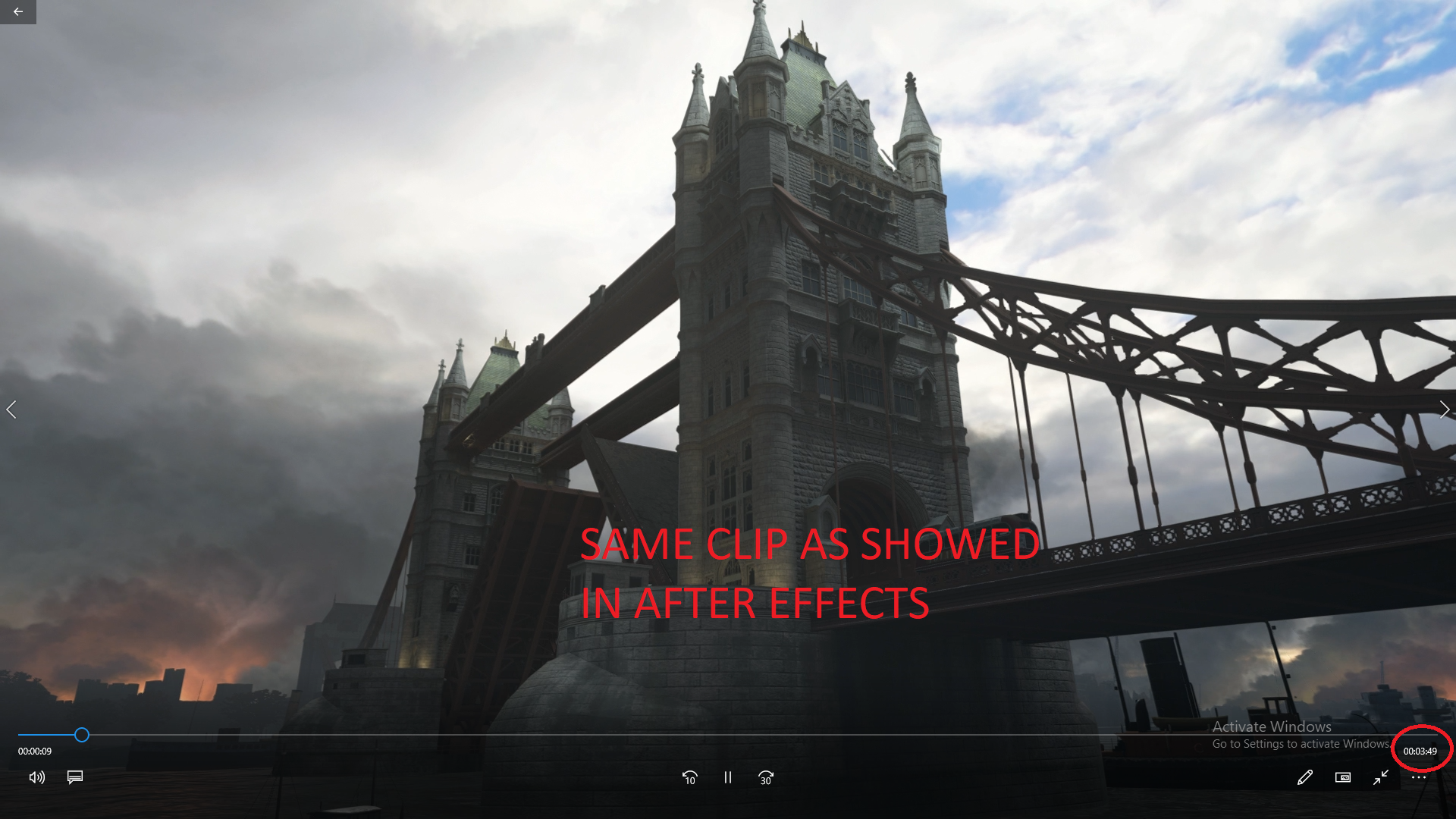

What do you suggest I do?
I used the same clips before and they were fine.
Its when I drag them into the project media section it says on the right side beside the name Duration 00:00:01 when its a 2 min video.
Its always stuck on the first frame when I make it into a composition and when I extend the composition duration the clip stays at 1 frame.
I've tried replacing the files and even reinstalling after effects again but no luck. It seems to be only mp4 files that are causing this but then again 2 of them still work so I'm really not sure, I can send a screenshot if you'd like?

In the project panel, right-click on the clip, and choose Interpret Footage > Main.
Let's see a screenshot of what's in there. Is it possible it's interpreting your footage at some strange framerate?
I see this is likely screen capture footage, which can sometimes be created in strange codecs, variable frame rates, etc.
Do you have any other clips that were captured this same way? If so, are they having the same issue, or just this one?

There are 5 clips that this happens to. They were all captured the same way
but I captured 2 other clips like this and they are working fine
