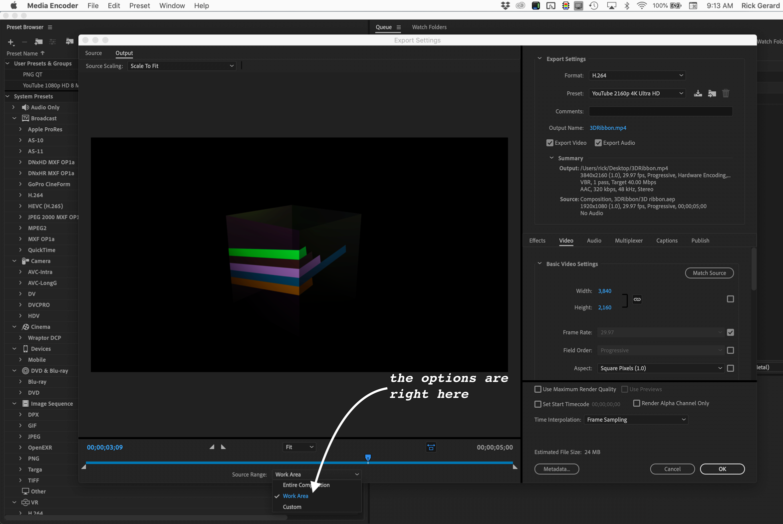

May 25, 2019 May 25, 2019
You have probably set the work area to half the video, then not selected the entire video in the rendering options. You need to pay attention to the UI and make sure you see and understand everything you see there. Try resetting the work area, change the options in the Render Settings to the length of the comp, or do the same in the Adobe Media Encoder.

I don't think that there is anything wrong with my work area/composition. When I go to Adobe Media Encoder, it says that it will export 50 seconds of the video (which is the full length of my video) but when I try to watch the video ON Media Encoder, the video stops loading after 10 seconds.

If the rendering locks up at 10 seconds then there is something going on in the comp at 10 seconds that is causing the hangup. You have to look at the comp to try and figure out what is going on there. Some problems just cause a hangup, others cause a failure. Some even cause a crash. It's not an AME problem it's a comp problem.
