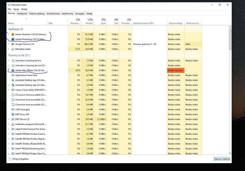

Here is PrintScreen from my Task Manager. As you can see PS and AI open correctly, but AE opens as a  background process. Still working on processor around 3,7%, high energy consumption, but can't open.q1.JPG

I have the same issue. AE CS4 worked on Win 10 with FX-8350 processor but after upgrading to 3960x with the same system it stopped working as described above.
There are some options in AfterFX.ini that looks compelling to tune them to fix the problem. RAM chunk and start address - could you reviel what they exaxtly mean and what values are possible? Maybe changing them will makje CS4 work again.
Votes
New Here ,
Sep 29, 2020 Sep 29, 2020
Copy link to clipboard
Copied
After some research I fixed the problem. SMT (Simultaneous Multi-Threading) was guilty. It caused that AE stuck in the background. It was enough to turn SMT off in BIOS and AE CS4 works again! 🙂 Just remember that some applicaitons like Blender have 30% worse performance when using CPU with SMT off but knowing that from time to time you can turn it on/off depending what is needed.
