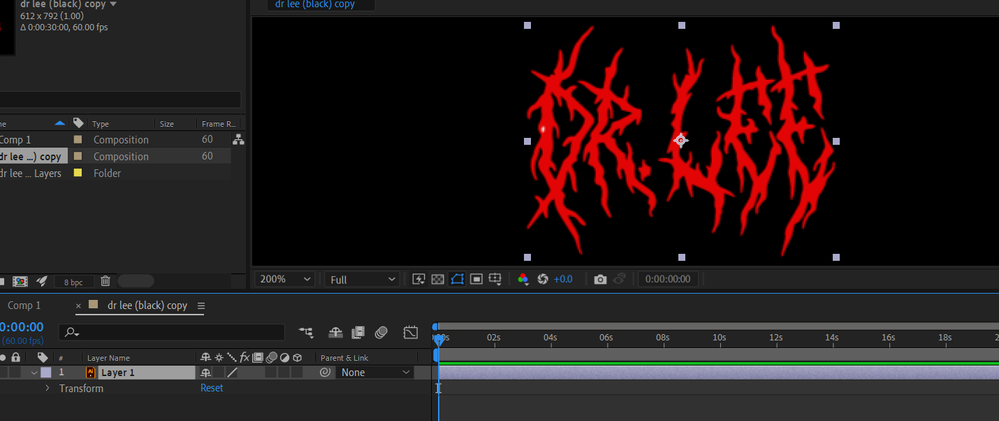

Votes
New Here ,
Mar 23, 2023 Mar 23, 2023
Copy link to clipboard
Copied
this is the problem i am having which i believe is the same....how do i fill the shape layer once ive made it
