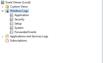

Thank you. Would you be so kind as to tell me which part of the Event Viewer should I be looking at?
LEGEND ,
Nov 20, 2022 Nov 20, 2022
System and Application, apparently. Filter it for AfterFX.exe or critical events with a red warning sign.
