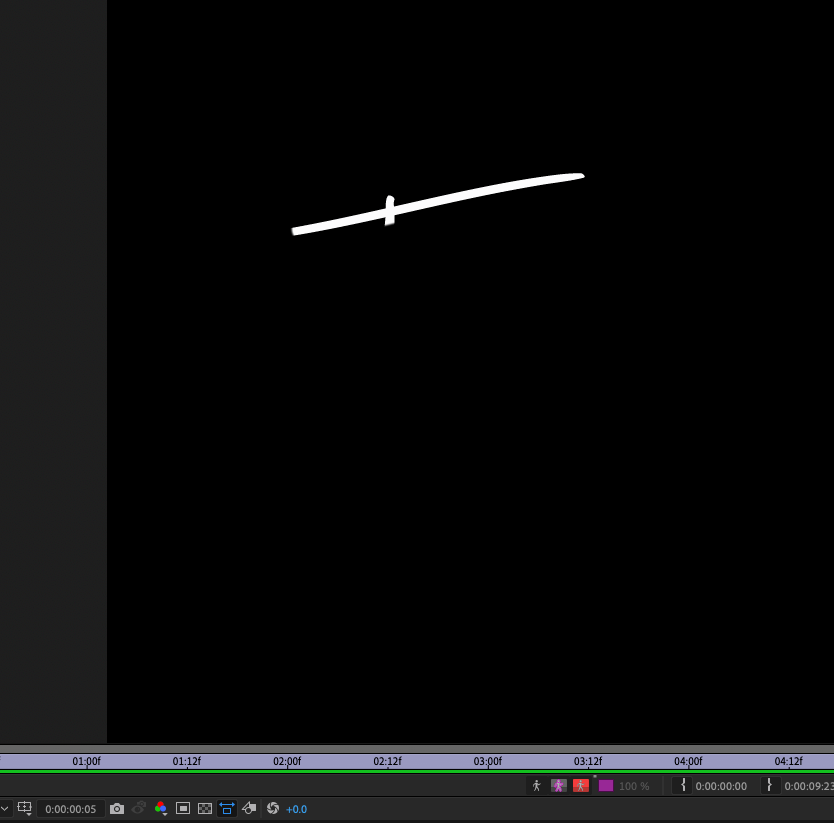

I am trying to animate my signature and I have it working, however where two stroke paths cross is not drawing properly.  My name is Tim and I start out writing the top of the "T", then the vertical of the "T".
When I animate this AE is drawing the top part and including just a bit of where the top and vertical cross (see attachment).  I cannot figure out how to correct this.  Any ideas?

Just so you know it writes the vertical part as it passes over the vertical line instead of "after completing the horizontal line".
Dec 19, 2020 Dec 19, 2020
This can be a little tricky. You could try to get the stroke value low enough so that it doesn't reveal where the signature crosses vertically.  You'll probably be happier with the results if you take the time to break your signature layer in the multiple layers based on how the lines would appear as wrote them (probably via a quick trip to Photoshop). It becomes a little more to work with as you have to apply the right on effect multiple times, but the improved and result is usually worth it.
100% this. Think about the way your pen tip moves when you're doing this in the real world. After Effects doesn't know that you're trying to recreate a realistic write-on, it's just revealing what you tell it to reveal.
Trimming/dissecting the letter forms into the actual lines you want to appear is the key here, via masking or in Photoshop/Illustrator.
If this is a font, you can usually be clever and re-use letters that appear more than once in your word(s) to save having to re-dissect them.
