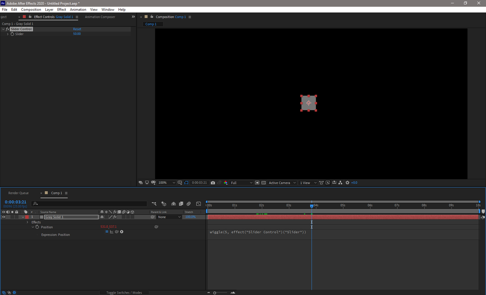

Hi, I'm making a simple animation for a flying fly using the "Wiggle" expression.
I want the fly to fly around for a moment and then land on something. My problem is that the wiggling needs to stop once the fly lands, but I don't know how to momentarily turn the wiggling values to zero. All suggestions are greatly appreciated

Add a "Slider Control" effect to your layer, in the wiggle expression use the expression pick whip to link your expression with the slider parameter like the following:
Now you can animate the "Slider" value of the "Slider Control" effect from any value to 0 to eliminate the wiggle.

Perfect!
