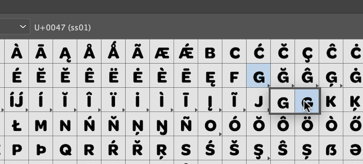

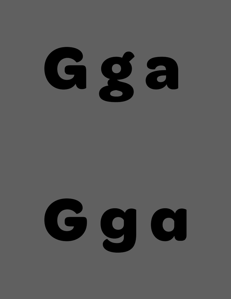

This goes a bit beyond my knowledge of how glyphs actually work, but I'll try to follow along as best as I can. Attached are two screenshots, one of the letters and their replacements, and one of the charmap (...assuming that's the charmap :D)
The three replacement glyphs have a little addition to their name (U+00...), ss01, ss05 and ss07 (G, a and g).

I've looked a bit more into this. Selecting a letter to replace (in this case "replace(/a/gi,variablename)") works great, and using "variablename = String.fromCharCode()" replaces wonderfully, I can't seem to find my alternate letters (residing in the stylistic sets "ss01" and "ss05") in that list. After looking further inside FontForge, these stylistic sets have a unicode value of -1, so I don't think "formCharCode()" will work here.
