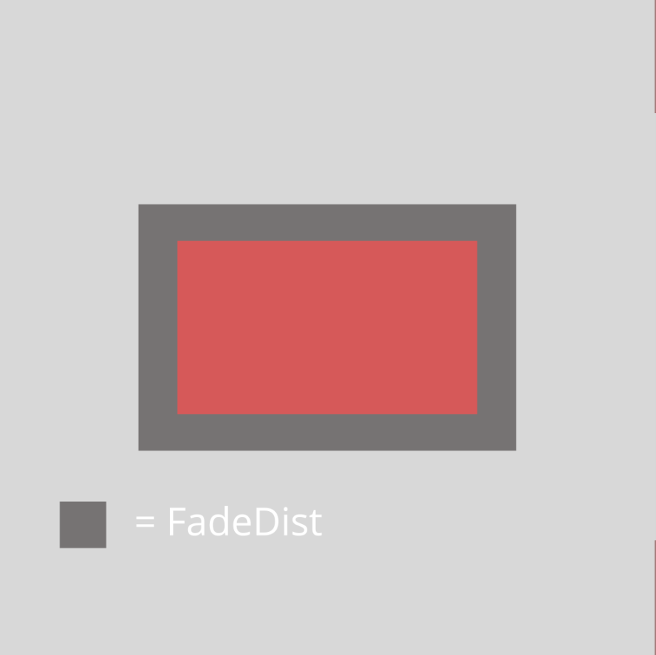

Visually, here's what I'm looking to do. The code I've gotten so far (see above) basically accomplishes this (the red rectangle is the target layer):
Again, it works fine if/when the target layer was a square or circle. But if the mouse is coming towards the target layer from the top or bottom, the rectangle starts scaling up much sooner than if/when it's coming from the sides.
So, I'm trying to find a way to make the FadeDist work more like this, where the fade "boundary" is even around all the edges of the shape, if that makes sense - and then once the mouse is inside the are of the rectangle itself, the rectangle's scale doesn't change.
Given we can calculate the distance from the center to the mouse layer (i.e., green dot), is there some way we can calculate the distance from the center to the edge of the rectangle along the length "line", and then add a boundary around it?
Would one way to do that be to create a second rectangle and just add a certain amount (i.e. 100px) to the length/width, effectively creating a 100px boundary around the target layer, and then use the expression you wrote to calculate when the mouse is within that second layer, and then use that to affect the scale of the target layer?
