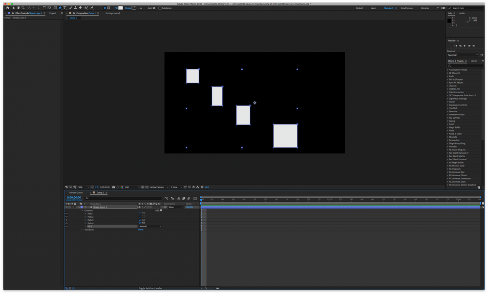

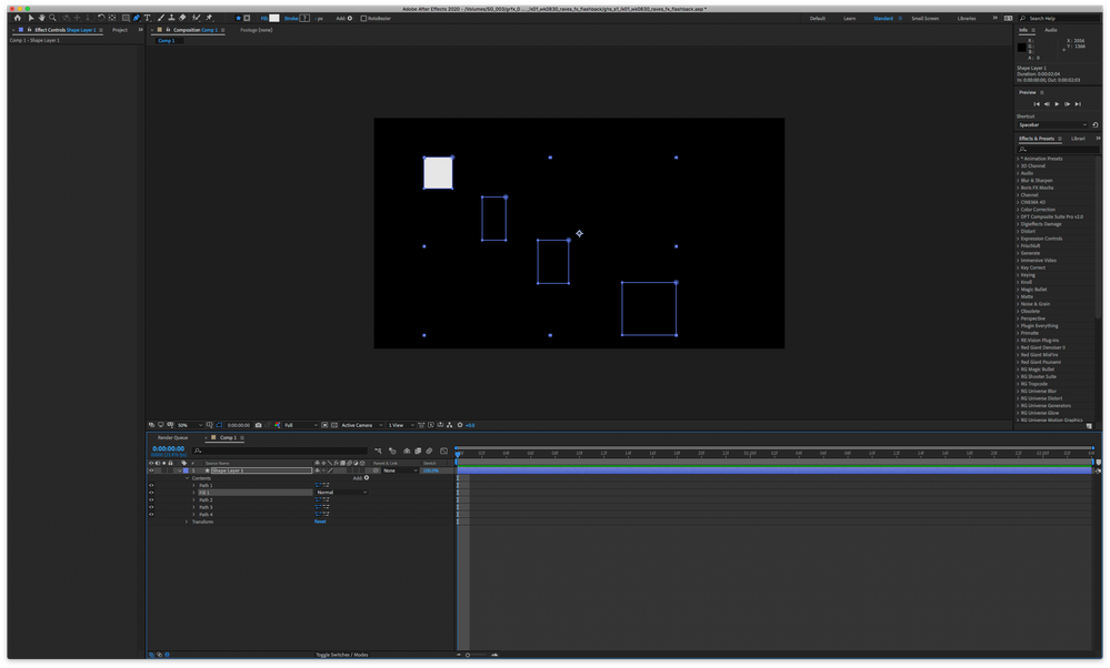

It's a little hard to tell from your 2nd screen shot, but it looks like you need to drag Fill 1 below Path 2, Path 3, and Path 4 in the Contents tack.
Here's a before and after example:
Fill 1 below Path 1, but above Path 2, Path 3 and Path 4.Fill 1 below Path 1, but above Path 2, Path 3 and Path 4.
Fill 1 below Path 1, Path 2, Path 3 and Path 4.Fill 1 below Path 1, Path 2, Path 3 and Path 4.

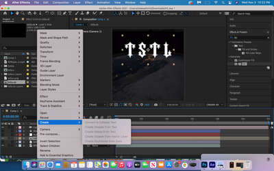

Is your goal to turn the Illustrator paths into After Effects Shape Layers that can then be extruded?
Try selecting the AI file in the Composition and then choose Layer > Create > Create Shapes from Vector Layer.
This may also be helpful:
Community Beginner ,
Nov 03, 2021 Nov 03, 2021
Tried. option is blocked out
Your  screenshot shows that the selected layer is a nested Composition.
The selected layer needs to be vector source footage, like an Adobe Illustrator document with outlines (text objects need to be outlines, Appearances need to be expanded, etc.).  It could also be an EPS file.
