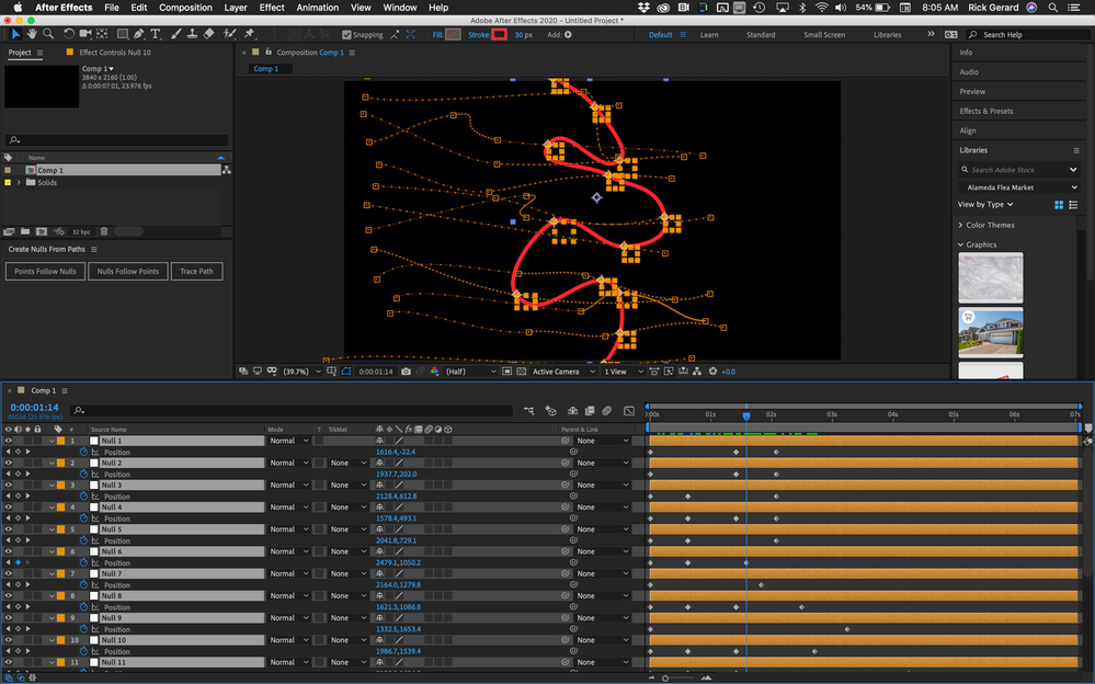

Second, as Mylenium said, there is not much to simplify. You could do everything in that video in After Effects by simply animating some shape and text layers. There are a lot more creative ways to make a more interesting map.
You can tie a path (the red line) to nulls using the Points Follow Nulls option in the Create Nulls From Paths.jsx that is included in the latest releases of AE. Animate the null's position to show the advancing armies and it will pull the path with it. That would probably be my approach. I would also probably choose RotoBezier for the path option, then just use shape layers for most of the graphics. Maybe this screenshot will give you some ideas:
It would also help us help you if we know your experience level with AE.

Hi Rick, thanks very much for your input as well, much appreciated! I'll try your method with the nulls. I didn't know you could do that.  I have a rather basic knowledge of AE. I know my way around the program and generally use AE for animated text, counters, infographics, animated masks for history maps showing invasions, etc. But I'm not really comfortable with expressions as I don't know the programming language.
