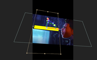

How do I disable this??????????
I have a composition called "Text" and nested as a layer in the main composition, when I activate the "3D Layer" casing to the "Text" layer and to a video that is in the main composition, both the text composition and the video take the same 3D perspective that I give only to one and I don't want it to be like that.

In your video, you're using the 3D camera tool to adjust the perspective of the text layer, instead of independently adjusting the rotation of the text layer.
The camera tools adjust the viewer's perspective, not the layer's position and rotation.  So when you make your second layer 3D as well, it's being viewed from the same camera angle and matches the perspective of the text.  Think of it like a real world camera.  When you move the camera, the perspective of everything in the world changes

I've been using CS6 for years, I'm not an expert or anything, but now that I reinstalled After Effects 2022 22.4.0, this function only slows me down and complicates the simple fact of giving 3D perspectives to compositions and elements (visual files, video, images. .). I already had AE 22.4 installed and I've done more complicated projects that also use Basic 3D and this feature hadn't appeared and wasn't a bother.
In the video you can clearly see how I create both compositions, I place one inside the other and apply a basic 3D perspective, wanting to apply basic 3D to the file called "Video", it takes the same perspective as the "Text" composition. as i never told him to do it like this, i want each element from different perspective.
The camera tools adjust the viewer's perspective, not the layer's position and rotation.  So when you make your second layer 3D as well, it's being viewed from the same camera angle and matches the perspective of the text.  Think of it like a real world camera.  When you move the camera, the perspective of everything in the world changes.
You should be using the position and rotation parameters of the individual layers to achieve independent control of each layer.
