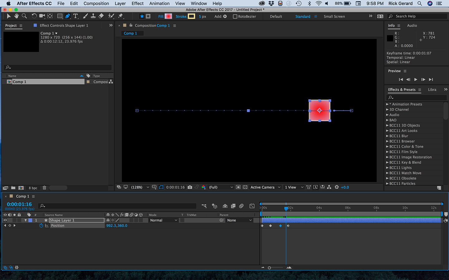

If you are getting rebound or ping-pong between two identical keyframes then you do not have temporal or spatial interpolation set to linear. It's that simple.
Select the position property of one of your layers, make sure you are showing all keyframes in preferences, use a view that lets you see the motion and carefully check the motion path and I will bet that you see the rebound. You can choose the pen tool and click on one of the points that have bezier handles while holding down the Alt/Option key and remove all movement between keyframes.
This is not a bug, it's user error. I see it all the time.
A screenshot of the graph editor or a close up of the motion path where you are getting the rebound will also show the problem. Here's a simple animation showing the position keyframes and the bezier handles and the value of the second keyframe and the third so you can see they are identical. The motion ping-pong's between the second and third keyframes.
This is the same animation with the CTI a little farther down the timeline and I have removed the bezier handles by using the Pen Tool and selecting both keyframes in the Comp Panel while holding down the Alt/Option key. No more bezier handles, no more ping pong.
You can do exactly the same thing using the graph editor or using keyframe interpolation or keyframe velocity. It's all just a matter of knowing how to manipulate the keyframes.
Prove me wrong by showing a screenshot that shows no bezier handles on the motion path and identical pair of keyframes that still gives you a rebound.
