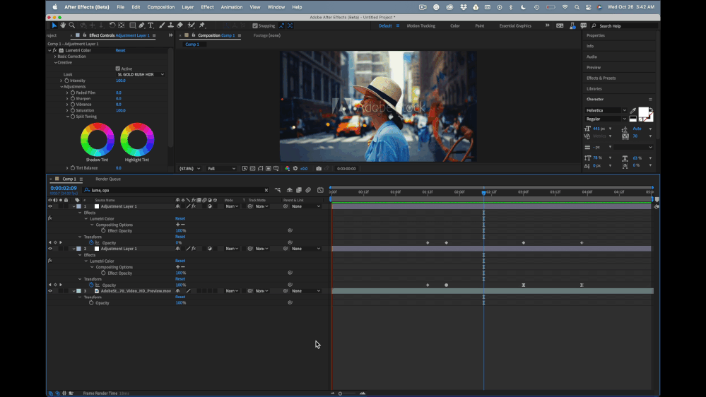

If you want to change the color correction on a single video and don't want to set up keyframes or split the layer, the simplest workflow would be to add two full-frame masks by double-clicking the Rectangle Tool, duplicate the effect (Lumetri), then add compositing options by selecting Mask 1 for the first instance and Mask 2 for the second instance. You can then animate mask opacity to switch between the two effects.
Adjustment layers tend to be overused, but if your project benefits from adjustment layers and the color correction needs to affect everything below them, there is nothing that is keeping you from stacking two adjustment layers, adding Lumetri to both, setting up your color correction, then just animating the opacity of the adjustment layers.
Compositing Options Animation:
Adjustment layer Opacity:
Use your own clips for the project file or download the sample video here: https://stock.adobe.com/video/attractive-tourist-in-a-hat-in-new-york-city/315658170
