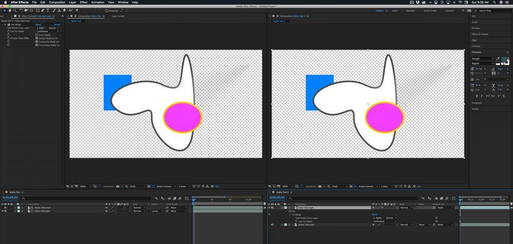

Here's how to set up Set Matte and Track Matte in After Effects. Everything I did is revealed in the screenshot:

Notice in all of the screenshots that I have shown the transparency grid and that the spotlight beam effect is very slightly visible in the transparency grid. It would be impossible to get that kind of detail if I had added a green background and tried to remove the green background in any app. The lighting effect is just too simple. Here's the shot in Premiere Pro composited over a night sky timelapse.
