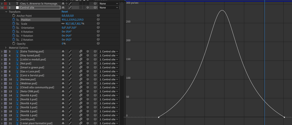

Basically I'm animating the position, scale and xyz rotation via speed graph.
As soon as I apply easy ease to the keyframes the situation is like this and everything is ok.
However, when I change the curve of each parameter (like this) the animation does not go well because it changes the path.

As before, we need to see the speed graphs of the animated properties, but also would be great to see the whole timeline and preview window, with the end position keyframe selected so we can see the motion path.  This looks to me like a bezier curve error on your motion path.

Can these two screenshots help?

I think the scale keyframes are causing the problem.  The anchor point of your layer is a long way from the top section we're seeing, so even a small change of scale will make the visible part move quite a lot.  Try temporarily deleting or moving the scale keyframes away to see if it fixes the issue.
EDIT:  Sorry, just saw your additional response after I posted.  So it's obviously the scale keyframes causing the issue.  Problem 1 you have is that the Anchor Point of your layer is so far away from the visible part of the layer. You could move the Anchor Point, but that will disrupt your existing position keyframes.
You'll also find that, in most usual situations, you want your keyframes for transform properties to be aligned in time.  So your position animation and scale animation should start and finish at the same time for a more fluid movement, and their speed should ramp up and down (ease) at the same rate.  Obviously there are many reasons for not doing this, but in typical situations you'll want them to be aligned - not a rule, just a common thing to consider.
