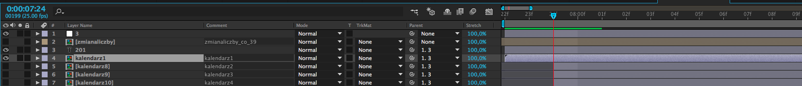

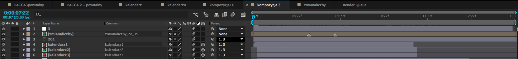

does activeAtTime() concern main timeline time or parent comp timeline time? If first, is there a way to address main timeline time?
This for example is part of my timeline. I wrote a function, which returns that layer1 is active at given time, which is true. But also it returns, that few layers inside mainComps layer4 are active, which may be true if first part of my question is. Here's what it looks like inside comps starting with main comp:

Explorer ,
Apr 08, 2016 Apr 08, 2016
when I check activeAtTime() of "kalenrzarz1" comp I get true for values 0 to 3.5, above is false. How is that corresponding to this timeline? I dont get it.
Explorer ,
Yes, even though marker is set at 7:22 and layers starts at this moment (timeline marker on the picture) comp "kalendarz1".startTime returns 0
Is there a way to address general mainComps timeline instead ?
Advocate ,
When the CTI (current time indicator) is at the very beginning of the comp, comp.time is 0, independantly of comp.displayStartTime
That's how it works.
Xavier
Explorer ,
Ok, I've managed to overcome this. While looping I check if curComp.containingComp.name === myMainComp.name, if yes then I create var tempTime = givenTime - parentCompLayerInMainComp.inPoint and check myLayer.activeAtTime(tempTime)
