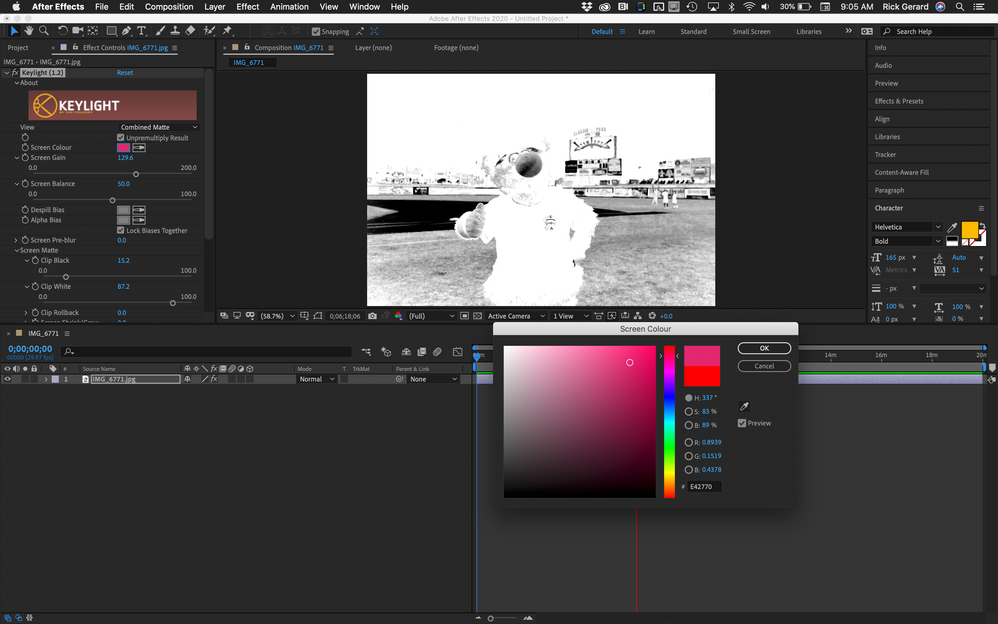

Try taking that shot into After Effects, add Keylight, look at the combined matte, increase the screen gain a bit, clip white and black, then start playing with the key color. You can pretty quickly see where you are going to have to create hold out mattes and which colors will give you the best results with most of the shot.
This red color gets me a pretty good key for most of the shirt and body leaving the nose, gloves, and whites in the costume so some roto is going to be necessary to include those parts.
If you don't have access to the hardware/filter combinations that make this job easiest You might be better off shooting against white and just doing a little roto on the eyes and the white parts of the costume. Lighting is going to be very important.
