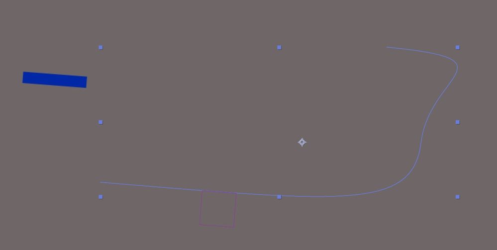

I am experiencing the same issue. To test the problem, I created a new project, then a new comp with a single path, then used "create nulls form path / trace path" and shift+picwhiped a rectange shape layer to the null but the rectangle gets placed far from the null.

Copying and pasting a motion vector path to a motion path requires that the layer with the mask or the shape layer with the mask have the transform properties reset to the default positions for the motion path to match up. This is because vector paths are based on the original layer dimensions, not the transformed properties.
The CreateNulls from Paths.jsx scrip will compensate for layer size scale and rotation so the nulls will be on the path no matter what the position, scale, and rotation of the layer have been set to.
When you Shift + parent a layer to another layer the position, rotation and scale are all matched at the Anchor Point of the layer. paper1246, your screenshot shows the outline of the null on the path, so that is correct, but you have the layer with the path selected. I would be willing to guess that the Anchor Point of the Blur Rectangle layer is right on top of the null. The reason that it doesn't match up is that the anchor point of the layer with the rectangle is not centered in the rectangle.
If the blue rectangle layer is a shape layer, and the rectangle is a parametric shape (Rectangle 1) and not a vector Path, then all you have to do is to select the shape layer, press the U key twice, and then zero out the Transform Rectangle 1 properties for Position, rotation, and scale if the scale is not 100%. That should move the center of Rectangle 1 to the Anchor Point of the shape layer.
