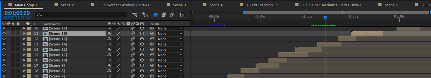

I received a pre-made movie with around 20 layers/scenes in it. I wanted to delete a layer/scene/slide (don't know exact name to use, will use layer) or two but when I delete this layer lets say layer 13 (the orange one) from the screenshot you will normally get a 'gap' between 12 and 14. When I then move slide(scene) 14 towards slide(scene) 12 to close the gap, I still see an empty blank field when i play the movie (because I deleted all content of 13 and removed 13 completely it is blank but not completely gone it seems).

So it now moves from slide 12 to 14 but with still the 3 seconds from slide 13 (but blank) in between. What am I doing wrong?
I just want to remove certain slides, and move the next one to the previous one with a few seconds of nothing...

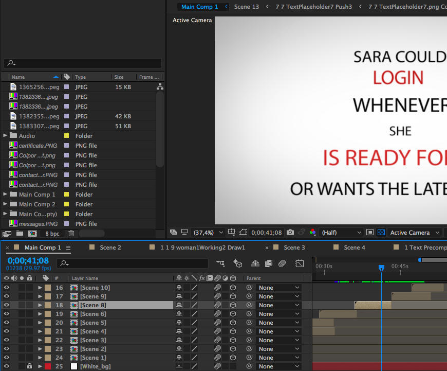

Thanks for the quick respons. I have done both but still have the same issue. Although when clicking on that button it shows me indeed some more layers. Here are some of the things that then showed up. Schermafbeelding 2017-01-06 om 19.49.18.png

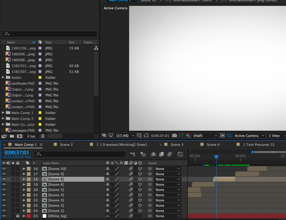

The white screen in the second screenshot explains why there is a white screen if there is no layer.. (should still see how to get this shorter or stop there), but as you can also see in that screenshot is that although I have removed scene 7 and moved 8 to scene 6 it shows me a white screen (because I removed scene 7)
and scene 8 simply starts when it would also start in the first place after a few seconds (after scene 7 is gone so to say). Then you see that scene 8 is starting. So below screen should start immediately after scene 6 and not with the white screen afterwards..

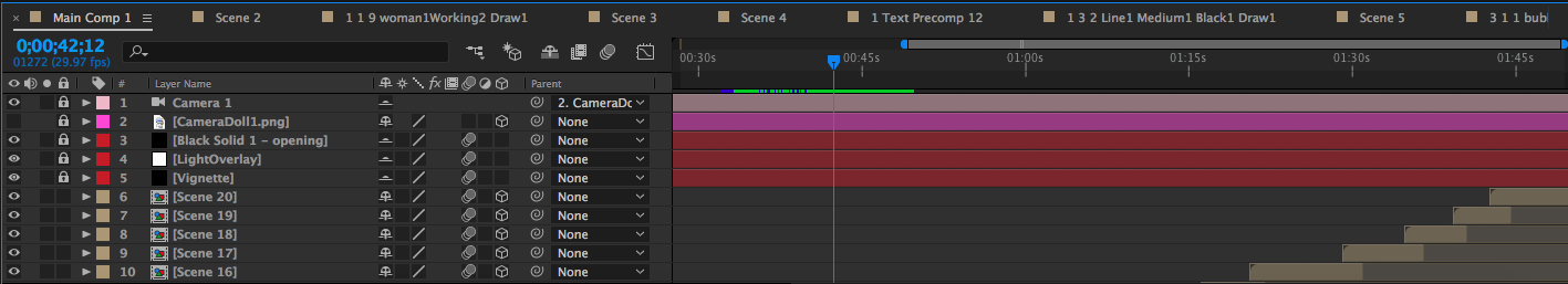

I think the problem is that the animation is not driven from what's inside these layers but from the camera
unlock the camera layer and highlight it. now press U and you will see keyframes - you will need to adjust those accordingly to make your animation shorter.

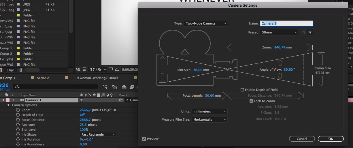

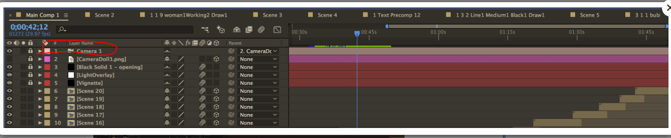

You are partly correct, because when I click on the 'eye' it shows nothing for all the images. So it definitely does something, but I cannot adjust anything in here which makes sense.. at least I don't know what I should change in here.
  Or should i adjust something in here or perhaps in the other layers

this is all by guessing here but you should highlight the camera layer and press U once. you will probably see keyframes. this is the camera moving from place to place showing the different precomp.
or - I see now the camera is parented to layer number 2
so do the same- unlock, highlight and press U. you will now have to adjust the keyframes to set your animation according to what you want.
it is painfully obvious you are very new to this software. this is obviously a setup that could be complex in so many ways we can't really help guide you step by step how to fix because we don't have it in front of us and because of your very basic to none skills in the software. if all else fails, you can always use the default template the way you got it and render it as is, and use an editing software to cut the parts you don't need. this software is complex and not intuitive.
